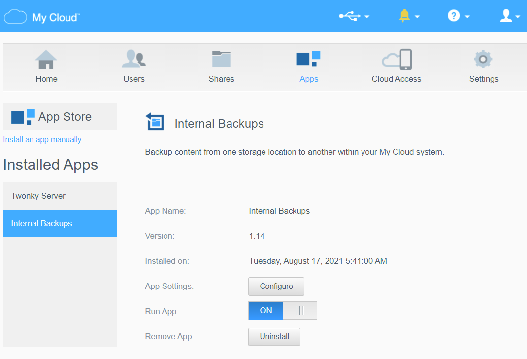

Are your apps showing in the list of apps in the Dashboard? What is showing if you click on one? See example image below.
Actually, I do k know exactly what I’m doing, not so much with NAS, yes the apps show up, I repeat, PhpMyAdmin need a physical config file to save its settings, which, under NAS, is not straight forward how to access, under the Windows system, I can go directly to said file and edit as needed.

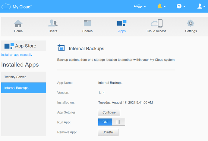

You did not say if you own a WD MY CLOUD or not. That is what I own, a 1st and a 2nd generation WD MY CLOUD. From what I read the phpMyAdmin will not work on them. See image below.
Yes, I Have My ICloud, PhpmyAdmin is restricted to local host, even the photo shows that.
