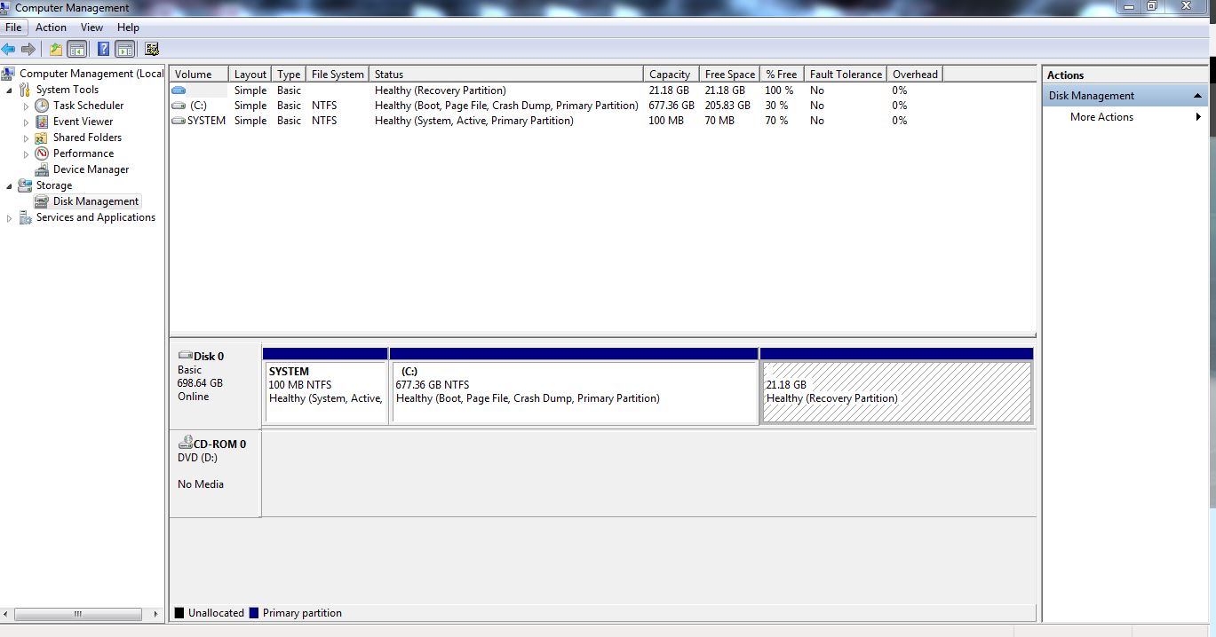

Although I don’t have any idea how to use this feature, I have opened disk management but it doesn’t appear to be showing there either.

I have contacted WD support and they have recommended replacement of the external drive as I have exhausted the troubleshooting options. Just thought I’d let anyone reading this in future know.
