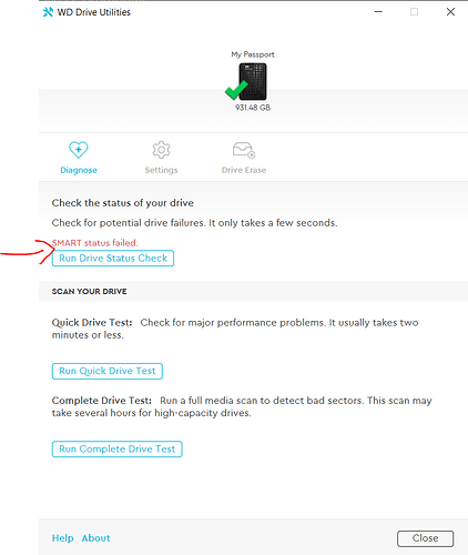

My well working WD my passport not showing in the drive now. It shows only in the disk management window to initialize the disk and it is unallocatted state and no more usable.
I need my data without losing. I tried to clicking the initialize with MBR/GPT but getting error as Virtual memory “Access Denied”.
My system details:
OS: Windows 10pro 64bit
Also I tried with WD driver utilities and i am getting below error
Please refer the below screenshots for more understanding my issue to help on this.

Yah I tried with Method 1, but system throws error during disk initialize request earlier I shared screenshot for reference.
And Method 2, not preferred since data will be lost.
Can you please any solution to resolve the disk initialize “Access denied” error.
Thanks
When “the request failed due to fatal device hardware error” occurs, your device turns inaccessible. This error usually occurs while attempting to transfer/copy files and suddenly the Windows OS fails to recognize the input or the output devices. In addition, this error could also be due to a fault in the systems hardware, inappropriate configuration, loose connections, etc.
To fix the error you can try the below DIY methods:
  1. Check the SMART status
  2. Run an error check
  3. Run CHKDSK scan
  4. Initialize the disk
Further, you can check the below blog to know more troubleshooting methods that can help resolving the issue and also helps to recover data from such drive:
Hope it helps!
