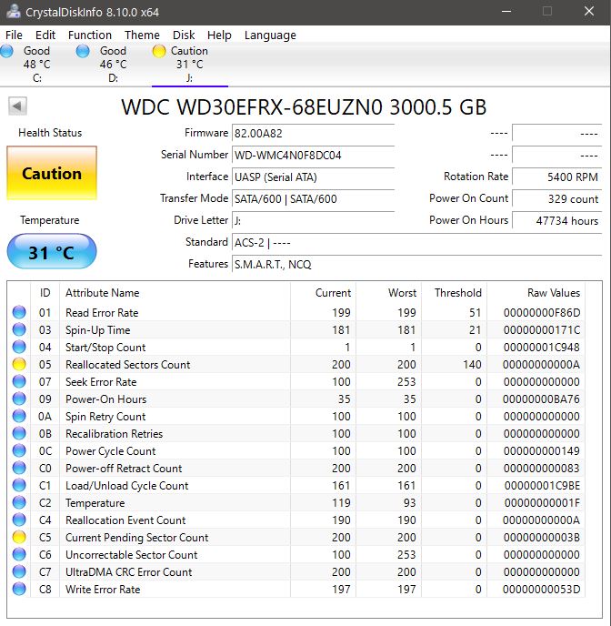

Took the drive out and with the Paragon software, I can access all data which has already been backed up. But as you can see below, CrystalDiskInfo reports >200 reallocated sector count. From what I can gather this is a bad sign that the hard drive is on it’s way out.

Thanks for the suggestions@Bennor. I went ahead and purchased another WD Red. Ran all commands on the @Fox_exe guide without issues. Sadly when I put it together there was a clicking noise and a solid red light . The clicking made me thing maybe there wasn’t enough power.
Decided to try the power adapter from the second unit I have to find out that was the cause of my problems. A $15 power adapter LOL not the $85 HDD …Oh well…the original drive also works regardless of the ‘caution’ SMART status on CrystalDiskInfo. Guess I’ll replace the HDD anyways so I feel that was a useful purchase and repurpose the “failing?” drive to another task.
