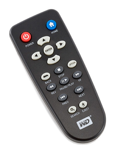

Are you using the genuine WDTV Live Hub Remote Control ?    or a Remote App ?
only asking, because you stated it also happens when the remote is “Off”
which doesent sound like you’re using one of these [Below]  (because the only way to turn this “Off” is to remove the Batteries)

Remove the Batteries from the WDTV Remote Control if you’re using one … (sometime remotes go faulty and start sending signals without pressing any buttons)

Thanks very much for the useful suggestions. I am using the original remote that came with the WD LiveHub. By ‘off’ I meant not using the remote; I proceeded by elimination and when I removed the batteries from the remote, lo and behold the random menu scrolling stopped! So the remote was sending unwanted signals on its own.
So the next logical question is, what could be wrong with the remote? I could try and open it to check if there are carbon deposits on the contacts, which may randomly conduct. If cleaning does not solve the issue, I will have to get a new remote. Anyone out there has a spare one? I live in the South Pacific, where things like that are hard to find.

I’ve cleaned my remote control twice over 4 years …
use an old expired Plastic Credit Card to pry the case open (don’t use a knife, it will damage the plastic and you might cut yourself)
Using a clean cloth and methylated spirits (or 100% alcohol)  … apply to the circut board and rubber button pad … VERY Gently clean (don’t apply too much pressure)
If it still gives problems … then your choices are
  1. Genuine Remote Replacement  (probably under $30)
  2. If you have a Smart Phone … download the WDTV Remote App for Android / iOS
  3. Use a USB Keyboard
  4. Universal Remote ?  (i know Harmony Remotes work, but pretty $$$$)
  5. Any OLD WDTV will operate “Basic Navigation Functions”
eg. the OLD WDTV Gen1 Remotes will work with the WDTV Live Hub [see pic below]
  1. Ebay has Heaps of WDTV Remotes
