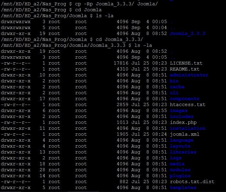

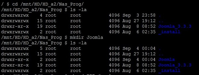

Anyway, here’s the thing…I was able to get a much newer version of Joomla to workon my EX2 back in 2014. The version at the time was 3.3. But the latest Joomla 3.5 may or may not work with the latest WD EX2’s firmware…and I neither have the time nor inclination to test the latest version. But for your benefit, I will post a bunch of screenshots I took back in 2014 detailing my install process - but it is only intended for folks who are comfy with Linux and command line via SSH. If you don’t have that familiarity then I am afraid this isn’t for you.
I will post the screenshots below - and the only writeup I can do is basically say that you simply need to create a symbolic link to the Joomla install directory (downloaded from Joomla site and unzipped) inside the /var/www/ directory (usually for Apache and nginx servers this is known as web root directory). Anyway, here’s the screenshots - you will have to figure out the details by looking at them (the key symbolic link creation is the one that has a red circle - and everything upto the dollar sign is the current path - I like to always change my command prompt to indicate current path). And please be aware that I had taken these screenshots back in 2014…I don’t remember much at this point…so even if you have any additional questions, I won’t be able to help you…not mention the fact that I don’t actually come to this forum much these days (my coming here was a random stroke of luck for you to be here within minutes of your post). Hopefully this is helpful and still valid for newer versions. (The screenshots may not show up immediately since forum mods take some time to approve them but usually the pics are approved within a day…and I have already grayed out some things like email for privacy…so these screenshots should be kosher).

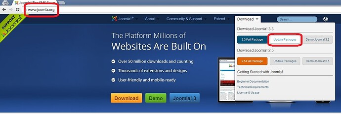

The following screenshots detail where I got the full version 3.3.3 from:
Do the steps outlined in following 3 screenshots via SSH access (which you need to enable on the EX2 from the settings first, if you have not enabled it yet):

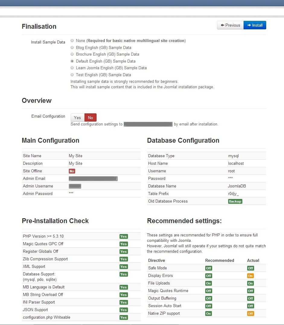

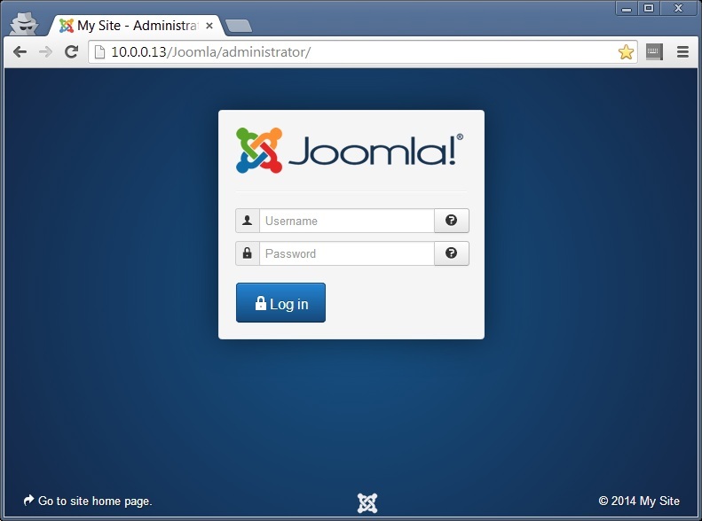

Then do the following setup from a browser pointing to http://[LAN IP address of EX2]/Joomla/ :

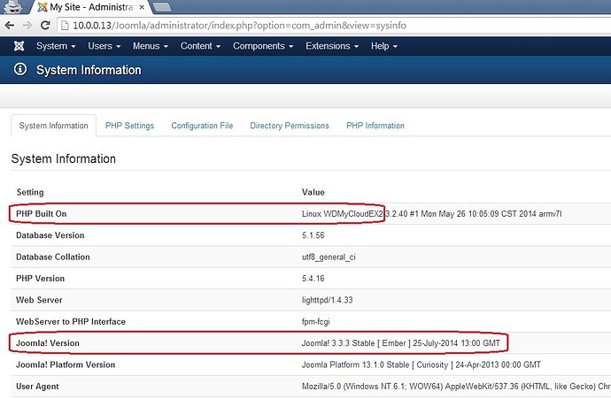

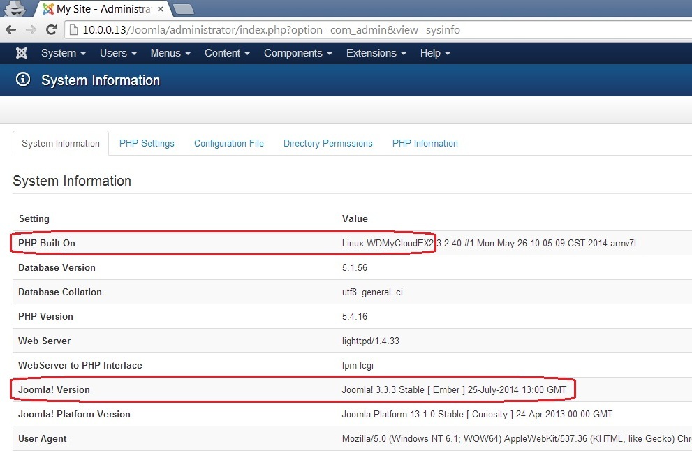

The following were just some post-install screenshots to show a successful Joomla install on the latest firmware running on my EX2 at the time:

I just came back to mention one important thing I forgot to mention earlier…which is, IF you have previously installed any version of Joomla on your EX2 (including the stale version bundled with EX2), you will have to drop (purge) all joomla tables from the MySQL database first before doing the fresh install.
