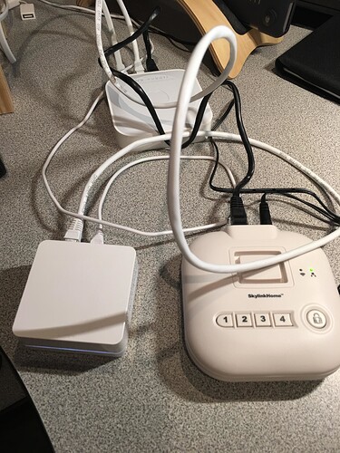

Here you can see the two base unit, the lutron bridge on the left and the skylinkhome alarm hub on the right. The Apple Airport Express at the top that acts as the Access point with the two devices connected via ethernet. This is all standalone and can be moved to my front door without any cables except three power outlets.

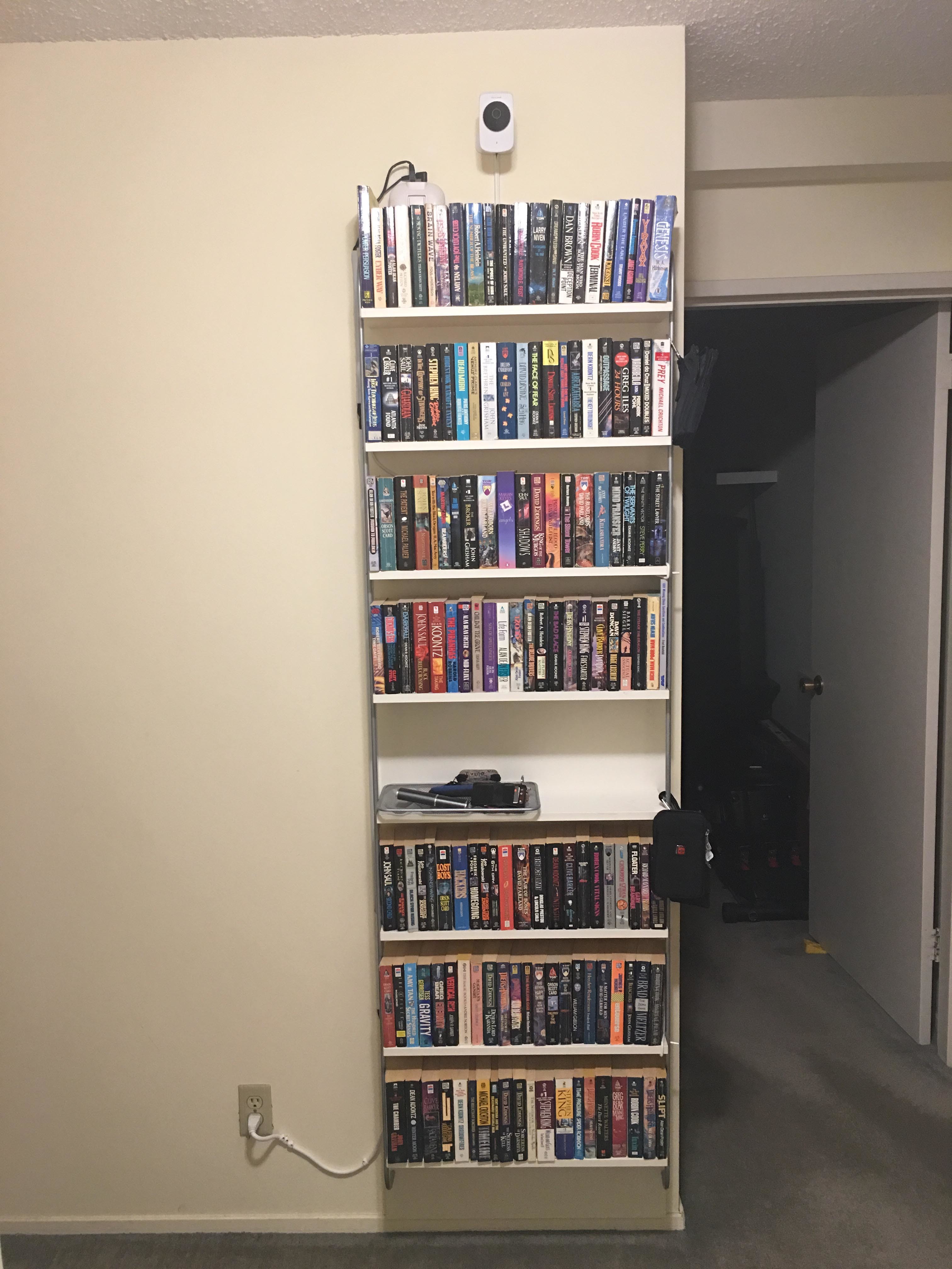

This is the foyer of my apartment and as you can see, the bookshelf is completely self-contained with the alarm peeking out at the top of the bookshelf; there is no ethernet cables.
Yes the alarm is a cheap alarm, more for belting out 110 decibel of sound as a warning. Pull the plug and the alarm goes quiet, however hopefully by then it would have sent me a notification to my iPhone, plus the camera above would have taken a few snapshots.

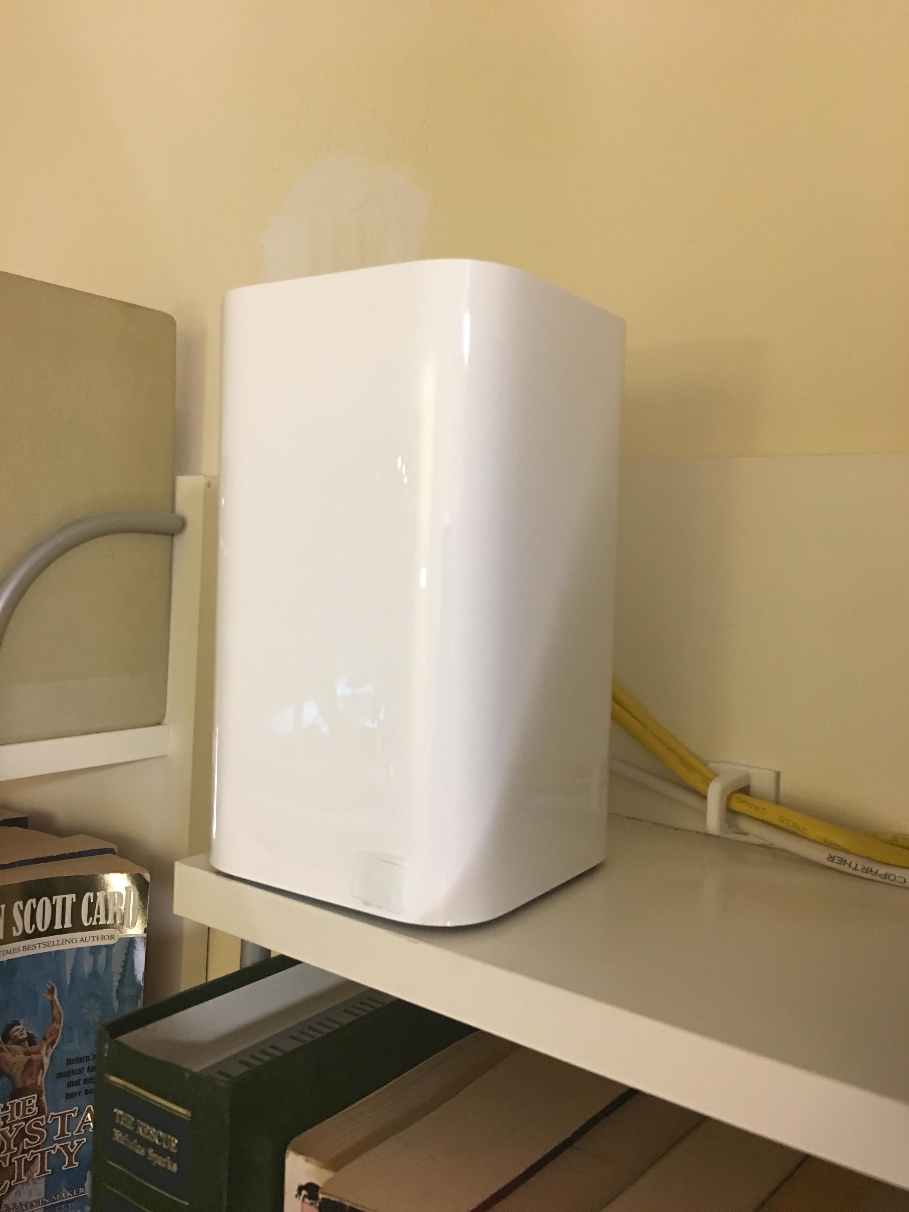

A very simple solution with an Airport Express using a WiFi Bridge, providing two wired ethernet connection.

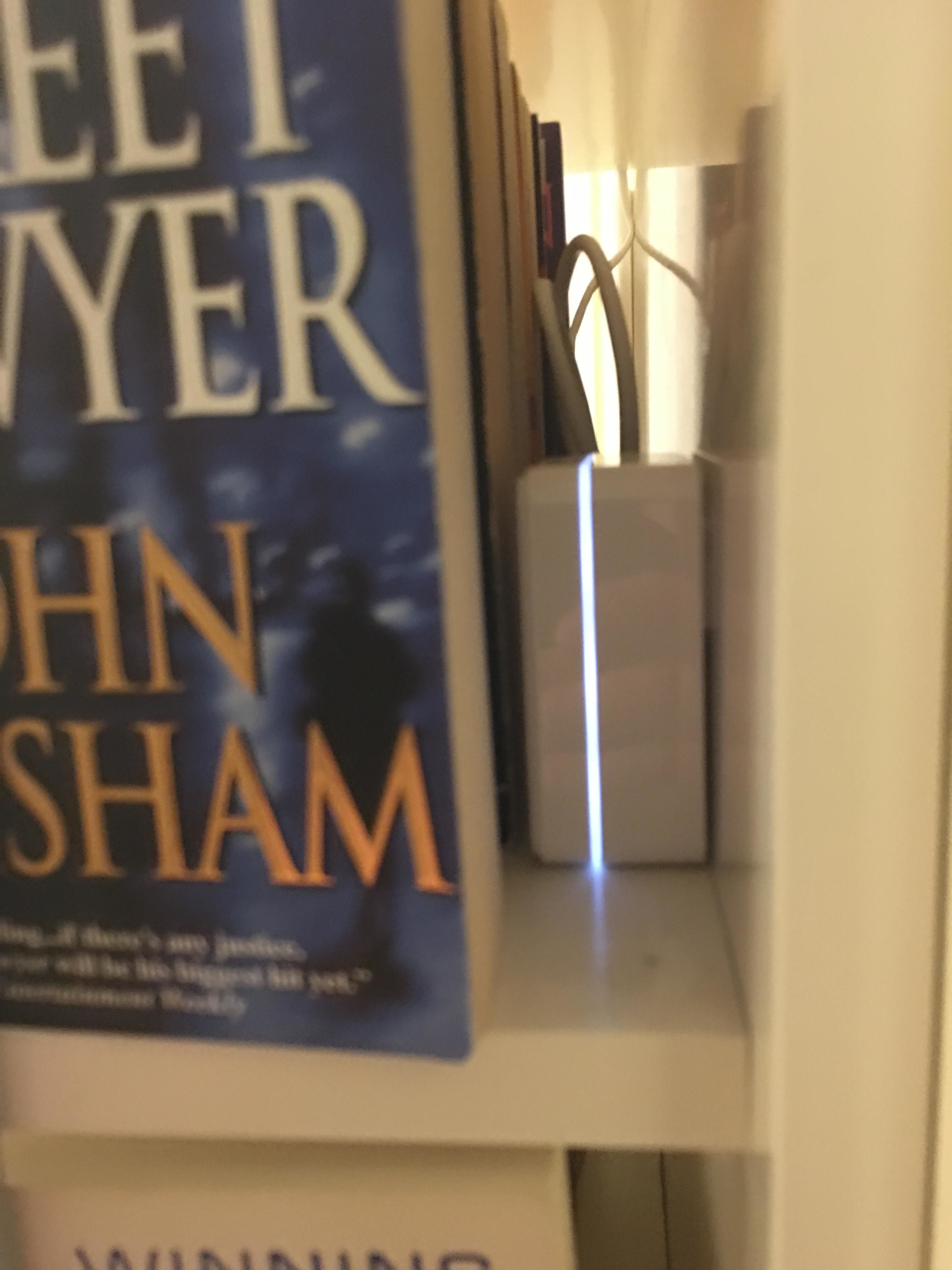

Here is the lutron bridge module hiding behind the books.

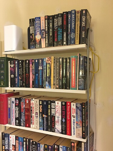

Now that we have move everything off the old shelves where the clouds are, we only need one cat 5e ethernet cable running to the Airport Extreme of which the two clouds are then connected to 2 of the 3 available gigabit ethernet ports.
It is extremely clean and organized. The gigabit network stays gigabit and my AC WiFi gets me an average of 40MB/s write with an average of 23MB/s reads; totally adequate for simple desktop chores.
