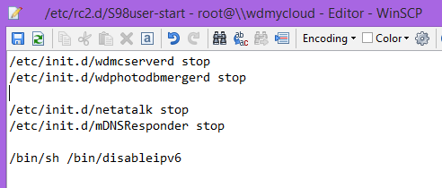

@ rac8006
Unfortunately I did not get this successfully his method, see how I edited the file:
But after a reboot, the services continued to work!
What else is needed to make it work? Before I was using crontab -e and worked.
JS
