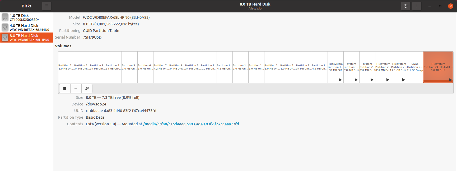

Hi Rajeev, in Ubuntu, log in as root in GUI, open “Disks” from software packages that come as standard with Ubuntu. Point to the drive (on the left side of Disks) and see if an arrow (indicating that it is mounted) is there. Must be logged in as root to take ownership of “everything that is possible”. In WD my cloud home configuration, only 6 partitions would mount (from sdb18 to 22 both included and then sdb24; in my case the relevant drive is sdb; but this may be different on other systems).
If you are not logged in as root, you will not have even access rights - a problem I encountered and couldn’t understand why, but all road blocks went away as soon as I logged in as root).
Note 1: from last night, the script on my system is still “searching” diligently and then copying files to the target drive. Double check immediately when the script works that it is getting reflected on the drive you want. Adding “dev/sdc/recoveryfiles” wont work as it will put the file on sda (drive of the system you are working on).
Note 2: In the springfield script (GitHub - springfielddatarecovery/mycloud-restsdk-recovery-script: A script to recover files from MyCloud REST SDK Folder Structure), it is noted “Not to slashes to the end of directory”. This statement may be true only if recovery is of files only. Since WD puts a deleted directory in “trash”, in the “dumpdir” I have added a “slash” in the script (media/…/WD4TB/8TBRecovery**/**).
Let me know if this helps. Good luck.

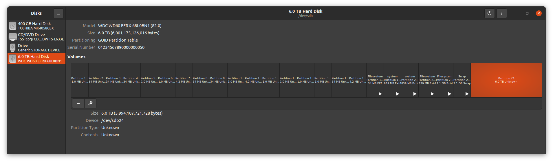

Arfan, Thank you for your advice, did follow your suggestion but still no luck with my drive, please find attached.
Try to unmount sdb23 (swap) and then mount sdb24 by using Disks. Swap shouldn’t be mounted. If this does not work, use “Testdisk” with “no log" option and then use advanced to check if you can see it.
