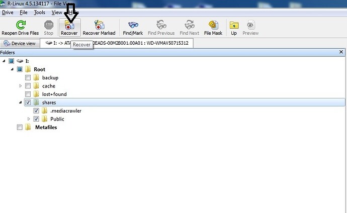

You will then be presented with a list of folders
Check the shares folder and then click the recover button up top. You will be asked where you want to save the files. Make sure to extract the data to ANOTHER hard drive

In my second picture, if you click on shares and then one of your shares, you should see all the files in that share on the right side of the screen. I believe they will have an X in front of the filenames as they were deleted.

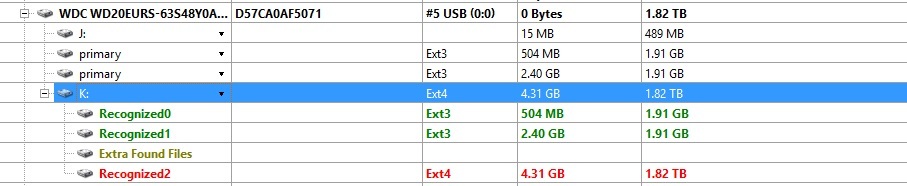

This is what I show after I scan…Which partition will my original shares be in?  so far no luck finding.
I can’t see your picture until a mod approves it…

When you double click on the K: EXT4 drive under R-Linux browse the drive till you find the shares folder and your data should be there if you browse the shares folder. Then just tick the shares folder and click recover. Again, I can’t see your pic so I’m not sure what your seeing

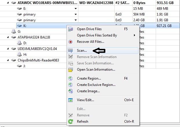

  1. Right click on your EXT4 partition and select Scan

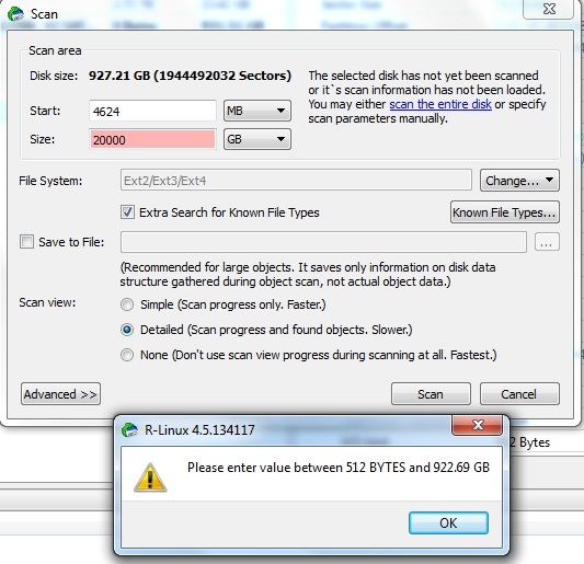

  1. Enter 4624 MB under Start
  2. Enter 20000 GB under Size and click scan
  3. You will get a message box telling you that the size is too big
  4. Enter the large value you see under “Please enter value between 512 BYTES and 922.69 GB” (I’m using a 1TB drive so your max value will be larger than the 922.69GB that I received because you have a 2TB drive
  1. R-Linux will now start scanning your data partition. You can see it has quickly found 2145 files very quickly

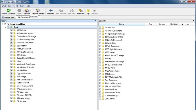

  1. When the scan is done, you will be presented with Extra Found Files under your EXT4 partition.
  2. Click Extra Found Files

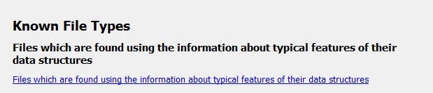

  1. On the right side of your screen you should see the following. Click “Files which are found using the information about typical features of their data structures”
  1. You will now be presented with file categories for all your found files. Simply tick Root and the Recover button and recover the data to an external USB hard drive or anywhere but the MyBookLive hard drive.
You can physically browse through each category and pick and choose which files you want to recover as well.
The bad new is the filenames will be generated numerical so you will still have to get the media in order once it is recovered, but the good news is it should be recoverable.

Now that I can see your picture, the Recognized2 folder may contain some of your files as well
I stopped my scan short so never had that folder show up
