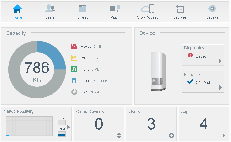

I try to login again via dashboard and this is what I see.:
This is a 6TB drive. All of my files are missing including my backups, music, etc. . I’ve about had it with this thing. It just doesn’t seem reliable enough to be used for backup storage.
I’m also not sure why it shows a caution. This is the diagnostics screen.

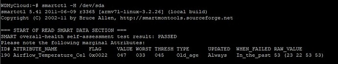

As a troubleshooting step you could try seeing the drive’s SMART values using SSH. Not sure if this will work on a second gen single bay My Cloud due to the different firmware used, but on a first gen the following (when run via SSH) will return some SMART information.
smartctl -H /dev/sda
Even though the Dashboard > Diagnoses says everything passes or is OK. The above command shows a “marginal” issue with air flow.
