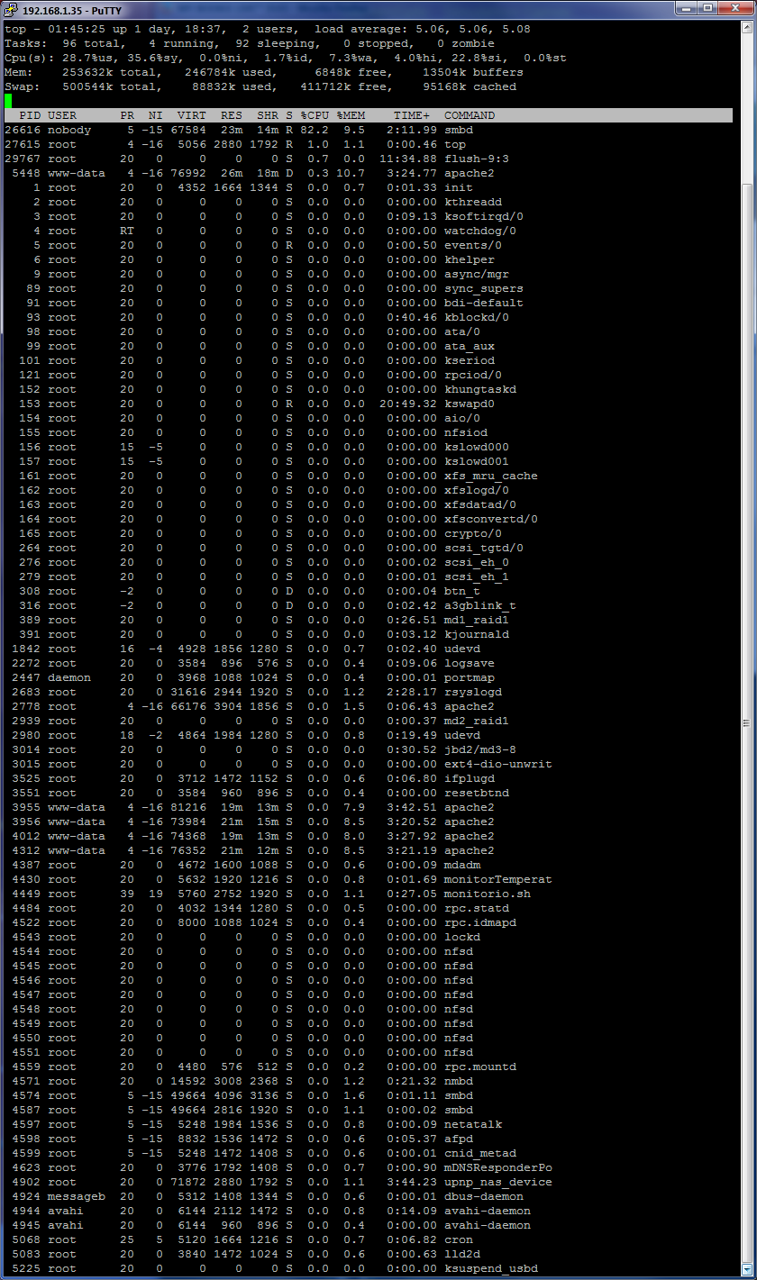

Log in via SSH and run the “top” process and see what’s going on during the upload process.
If that’s what the issue is, the processes can be safely disabled through various means (either permanently or temporarily) to improve performance during heavy file transfers.
I’ve never used SSH before so I’m flying blind here. I’ve figured out how to turn it on and downloaded putty. Typing “top” once logged on resulted in this:
If you want me to do anything more specific in ssh, you’ll have to explain it like I’m a 3 year old.
You’re right on target there.
Just do the same thing while you’re doing that copy of a million files.
Start the copy, wait a few minutes, then run TOP like you did above, and post a new screenshot.   You can stop the file copy if you want to after you’ve grabbed the screenshot.

That was during the copy.
