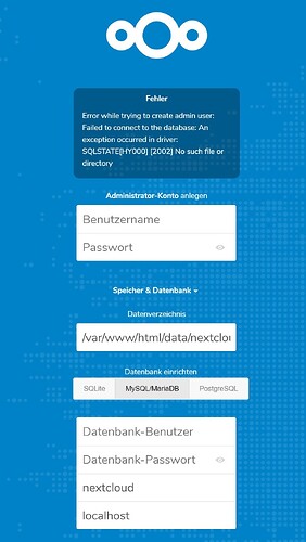

Only one question :grimacing:: How do I connect my NextCloud container to the MySQL database?
Using the standard SQlite I can setup the NextCloud without issues, but if I try to change the Database (at the setup beginning) an error message appears saying the following :
“Error while trying to create admin user: Failed to connect to the database: An exception occurred in driver: SQLSTATE[HY000] [2002] No such file or directory”
My NAS: PR2100 FW: 2.31.195
Thanks in advance for any help

The WD OS runs a MySQL server.
ps w | grep mysql
netstat -tulnp | grep 3306
Either you stop this server or you run the docker MySQL on another port.
I’d suggest to remove all containers (docker-compose down and docker container prune).
Then setup again and verify the db container is running
docker ps
I believe I had to link them in the last field with 127.0.0.1:3306, I remember some issues with name resolution for localhost.
Check the docker logs for anything going wrong.

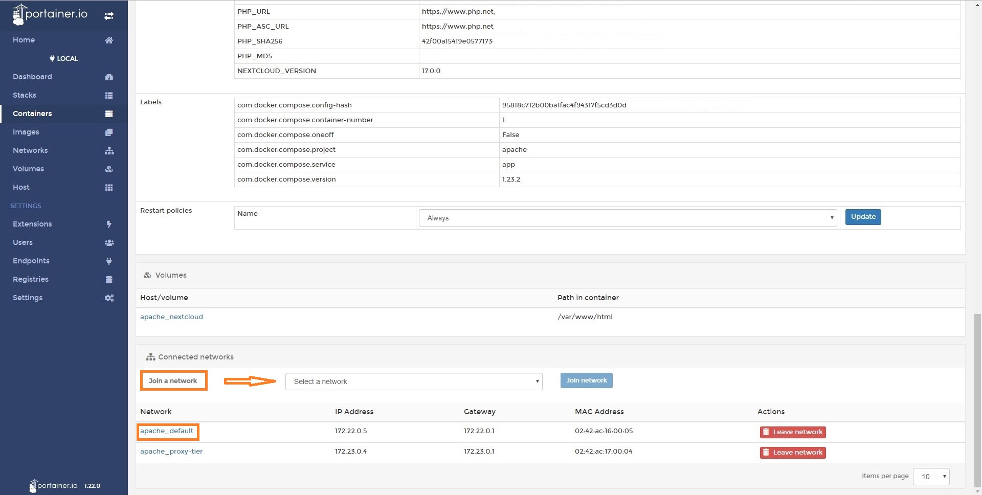

Thank you so much for your help Tfl :smiley:!.
The solution was:
1 - I completed the Setup instalaltion again using the standard SQlite DB
2 - Using the “Portainer” I just add this Container: - apache_app_1; apache_letsencrypt_companion_1; apache_proxy_1 to the “Network” : apaIche_default (see image attached).
3 - docker-compose down
4 - COMPOSE_HTTP_TIMEOUT=120 docker-compose up
and now the docker container is connected to the MySQL DB.
I have no Idea why , but I’m very happy to see that is working fine.
And thanks again Tfl for your help and for this incredible GUIDE!
Best Regards!
Glad it works for you. I think you may remove that apache_proxy-tier network, just put all containers in a single network.
