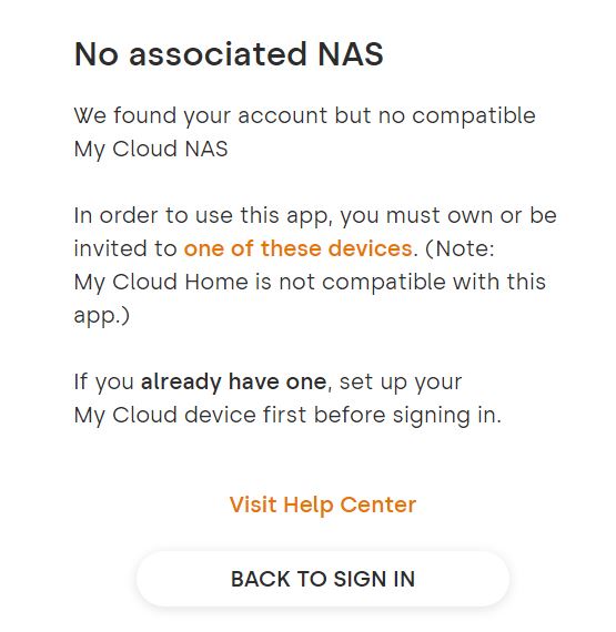

I am using this device ‘WD 4TB My Cloud Personal Network Attached Storage - NAS - WDBCTL0040HWT-NESN’ which I purchased in 2016. I did the upgrade just after they came up with OS-5. I did not have to create a new admin account. It did not prompt me. Old admin account worked to log in locally by going to http://wdmycloud/# to access the dashboard with all settings. Remote access with new OS-5 app stopped working for existing accounts giving this error “No compatible NAS”. Re-inviting existing accounts was giving the error code 403. All shares and files were preserved. I could access data on the network and stream media files to my TV. Only remote access was not available for old or new accounts.

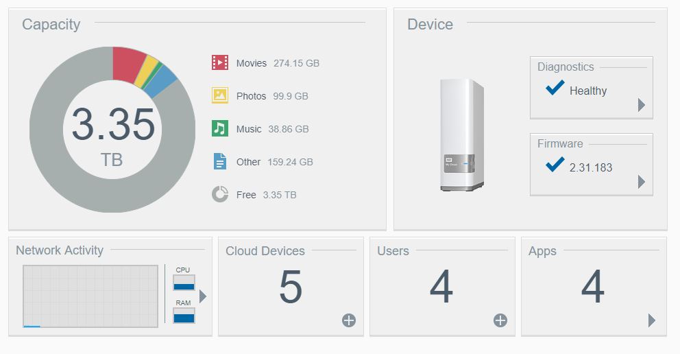

That’s NOT My Cloud OS5. You’re running OS3 firmware version 2.31.183, which is the source of your problem. All OS5 firmware versions start with the number five.
Your screen capture shows you ARE NOT running OS5 v5.x firmware. That explains why the OS5 app isn’t working. Additionally you are running a very old v2.x OS3 firmware version, from 05/20/2019. The last version of the v2.x firmware is 2.42.115 (1/18/2022). You may need to update to 2.42.115 firmware BEFORE attempting to update to the OS 5 firmware.

Actually, the latest firmware update I did was on 12/10 to 5.25.124. Whatever the newest version was available for the device I was updating. The screenshot I attached is old from 2019 (the only one I had). Sorry for confusion.
I’m curious. What led you to believe that posting a screenshot of OS3 would help solve a problem with OS5? They may look similar, but they are NOT the same.
