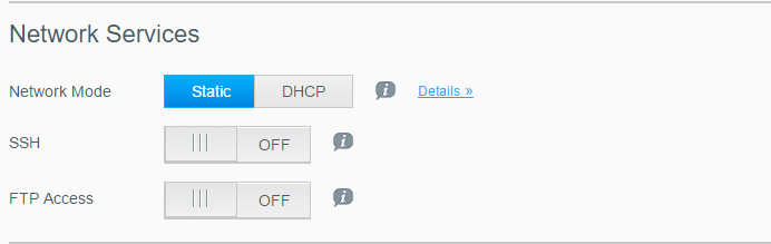

It was 228 Mbs and 379 Mbs. Here’s some other info on the setup on the WD side of it. This is connected directly via Ethernet. All of the devices on my network have static IP’s. I never have any technical issues with cloud after I permanently set up the path in Windows, but I wasn’t sure if the speed was underperforming.
I have remote access turned ON on the WD Cloud and it has static manual port configs. The routers port forwarding and trigger also have the same port numbers.
Yes it does and I currently have guest turned OFF for extra security. I was even thinking of adding the MAC Adress filter for extra security.
