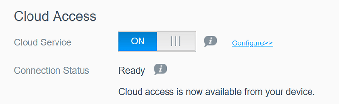

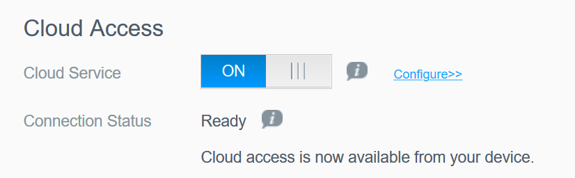

The “Cloud Access” on the device dashboard currently says:
“Cloud access is now available from your device.”
