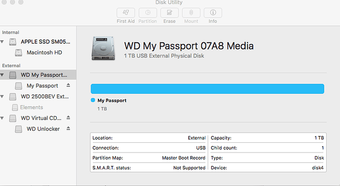

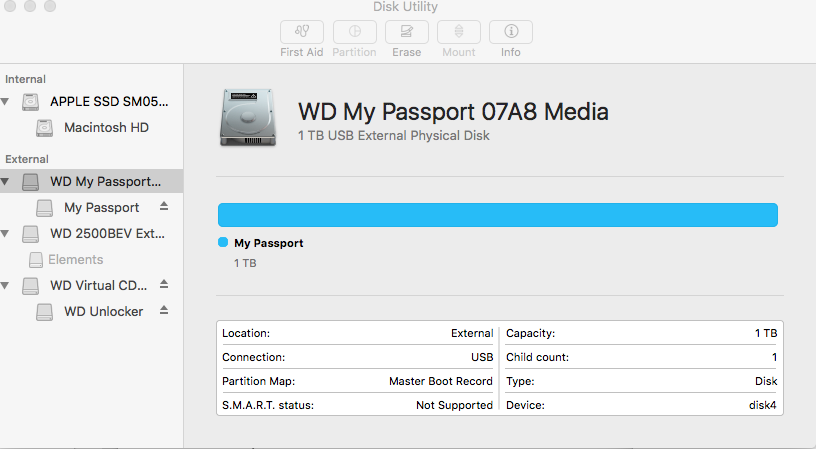

I am having the same problem with my WD My 1 TB Passport external hard drive. I am following instructions as per ID 3865 and when I select the drive the partition button is not available to use!!!
Richard
Based on the post from Klamation, try clicking on the “My Passport” just below the drive you are showing on the screen shot. Then click “erase”. You can change the name here and it will erase any files you already had. I tried this on my drive and it seems to have worked using the default options but erasing info was not an issue for me as the drive was new.
