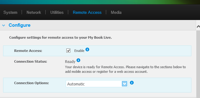

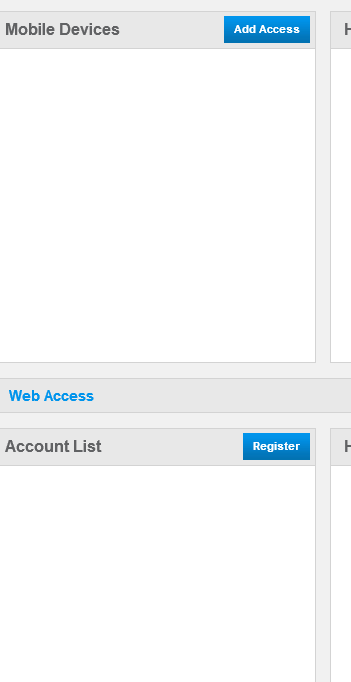

Deleted the Mobile Access Accounts and the the Web Access accounts and now receive a connection status of " Ready. Your device is ready for Remote Access. Please navigate to the sections below to add mobile access or register for a web access account.
The moment I try to add access to either a Mobile Device or Web Access the Connection status noted above.
Tried to include a clip of the ready status and no access accounts.
