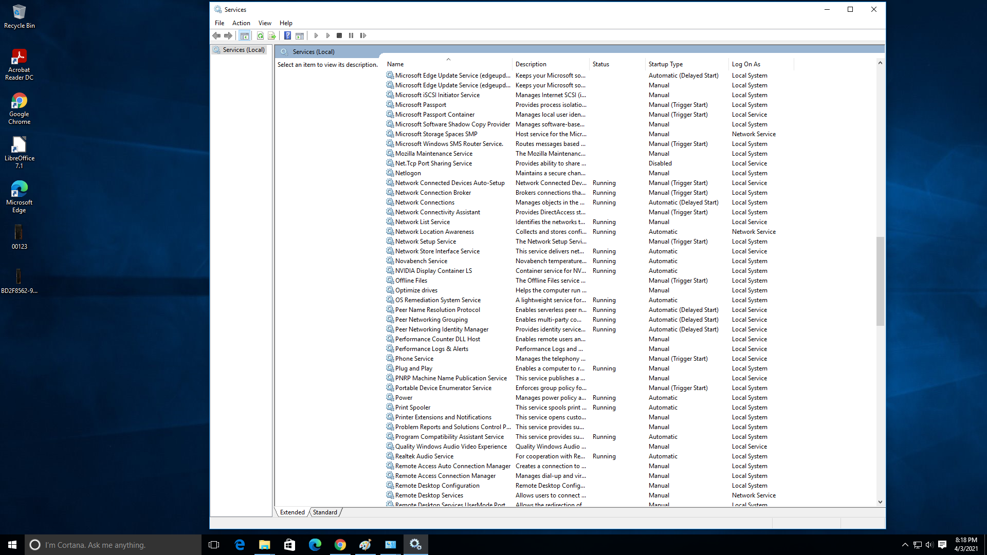

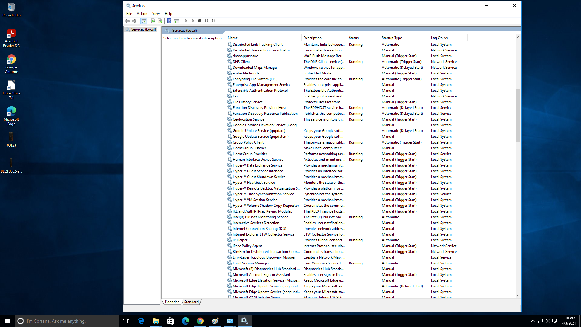

Windows-10 cant see MyCloud drives?

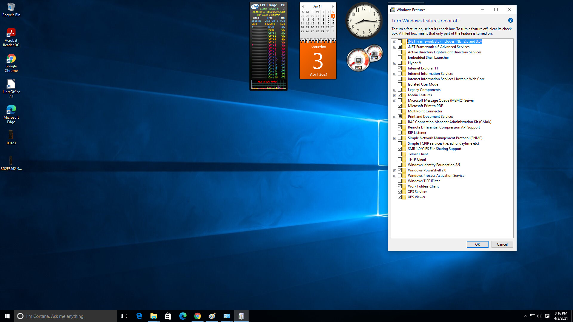

I know there was a problem with SMB being turn off but I checked my setting and it is turned on.
I turn SMB off and reboot and then turned it back on just to make sure.
But I still cant see my MyCloud drives.
The drives show up in Twonky and I can access the drives setup login screen.
I just cant see the drives in file explorer.
They should be where the red circle is.
I can see the drives from my other computers just not this one.
So something must be wrong with the settings.
I have a NEW clean install of Win-10-Pro with the latest updates applied.
With SMB1 on, have you tried to shut down your computer and then do a reboot/start of your computer?
Yes , I tried that. I also enabled Netbios over TCP/IP for WiFi and Ethernet adapters.
