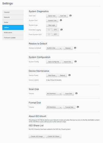

SOLUTION:
The only solution is to perform a System Only Restore and setup admin user using the correct email address. The changing of admin user email address and cloud device owner sync will be fixed in the next firmware release.
The Restore to Default area allows the Administrator to perform a restore on the My Cloud device.
Perform one of the following options to restore your system:
System Only : Reverts system settings to their default values, but retains user data and shares.
Quick Restore : Reverts all settings to their default values, erases all user data and shares, and retains default shares. Quick Restore creates a new file table on the device, but does not fully overwrite or erase the drive, so data recovery programs can be used to restore user data and shares.
Full Restore : Reverts all settings to their default values, deletes all user data and shares permanently, and retains default shares. Data recovery programs cannot be used to restore data; all user data and shares, with the exception of the default shares, are permanently deleted.
Important Before doing a factory restore or a system update, you may choose to save your device’s current configuration. At a later time, you can import a previously saved configuration. Keep in mind that importing a configuration after restoring factory defaults does not restore shares or users. See “Saving a Configuration File”, to create or restore a configuration file.Formatting your disk will take several hours to complete.
Note : To erase all of the data on your device, see “Format Disk.”
Restoring your System
Use the following steps to restore your system to one of the three available options.
In the Restore to Default area, click either System Only , Quick Restore , or Full Restore .
Click Restore .
Review the confirmation message and click OK. The device reboots. Don’t unplug the device during this rebooting process. Once the reboot is complete, launch the dashboard.
Important : Before doing a factory restore or a system update, you may choose to save your device’s current configuration. At a later time, you can import a previously saved configuration. Keep in mind that importing a configuration after restoring factory defaults does not restore shares or users. See “Saving a Configuration File” to create or restore a configuration file.
