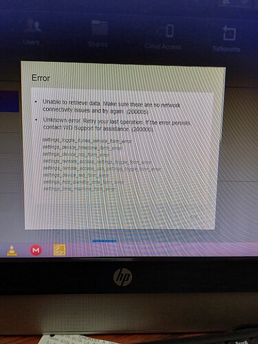

Sharing the screen shots of error

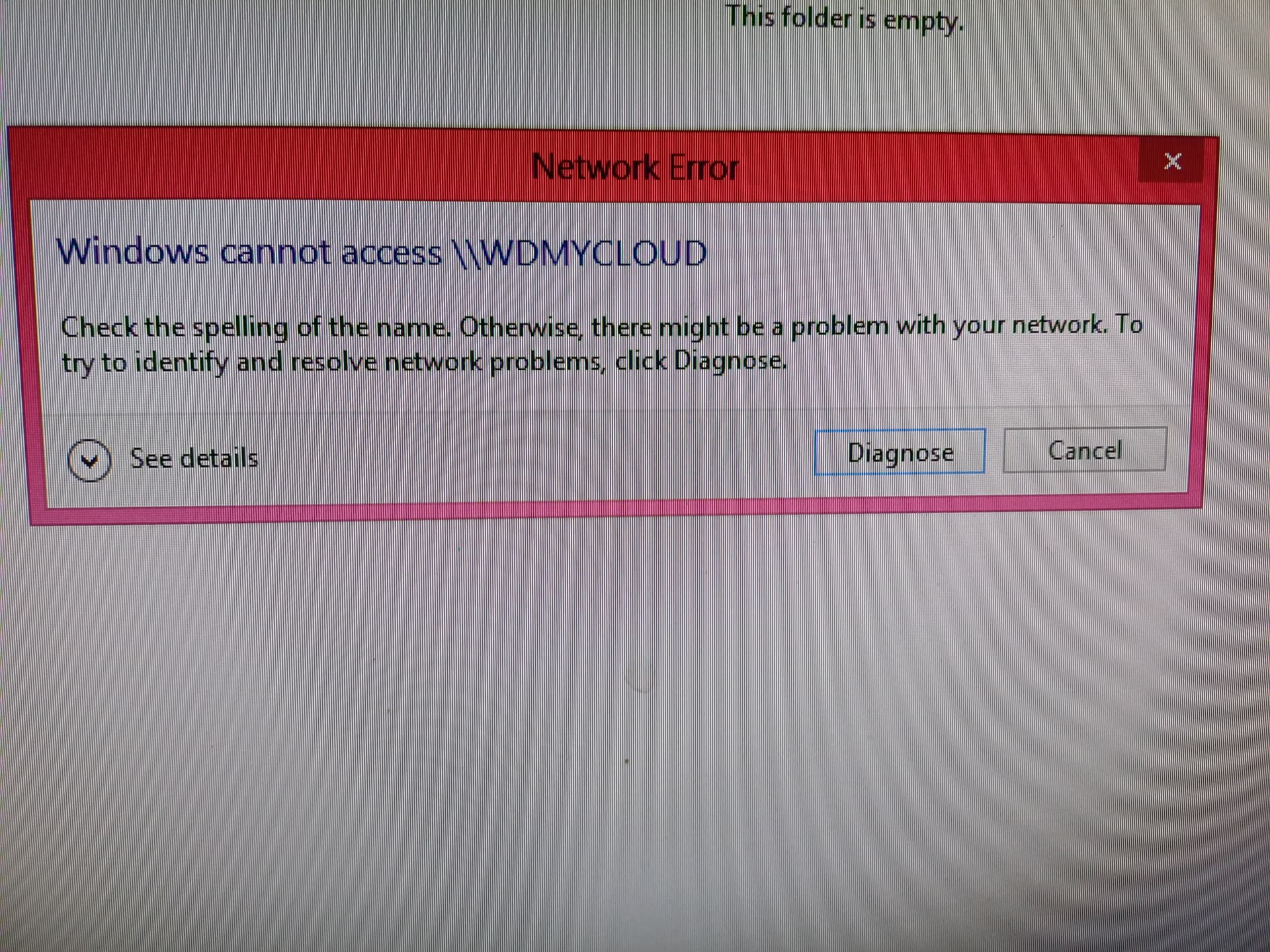

Also i am getting this error code on windows

This dialog message can sometimes appear in the My Cloud Dashboard when navigating the My Cloud Dashboard and the My Cloud looses local network access. Once the My Cloud regains local network access the message usually does not reappear in the My Cloud Dashboard.
Is the My Cloud directly connected to the network router or gateway? If not directly connect the My Cloud to the local network router or gateway.
