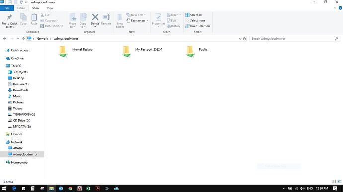

so what i can do to solve this issue, i cant mange my setting, backup manage, users
but i can access my files through local network normally
