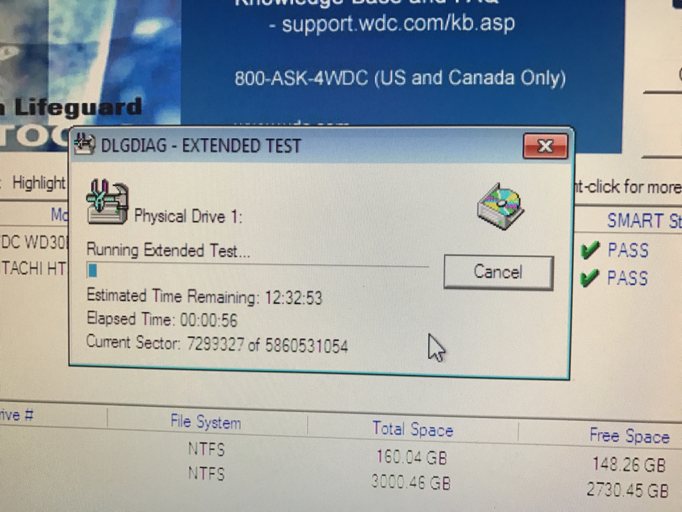

had some tests with the WD DLG in the meantime done. The tool reconize the faulty one as 2TB too but the SMART values, the quick test, the extended test and the full erase finished all without any error.
I have done the extended test with the good same model disk in comparision and I observed a different sector range which will be tested.
The faulty one:
The good one:
