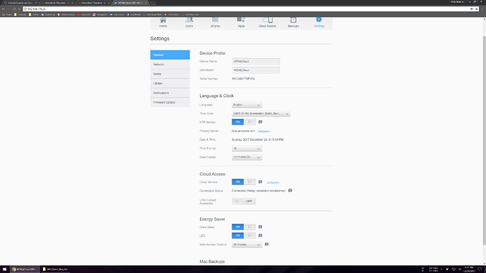

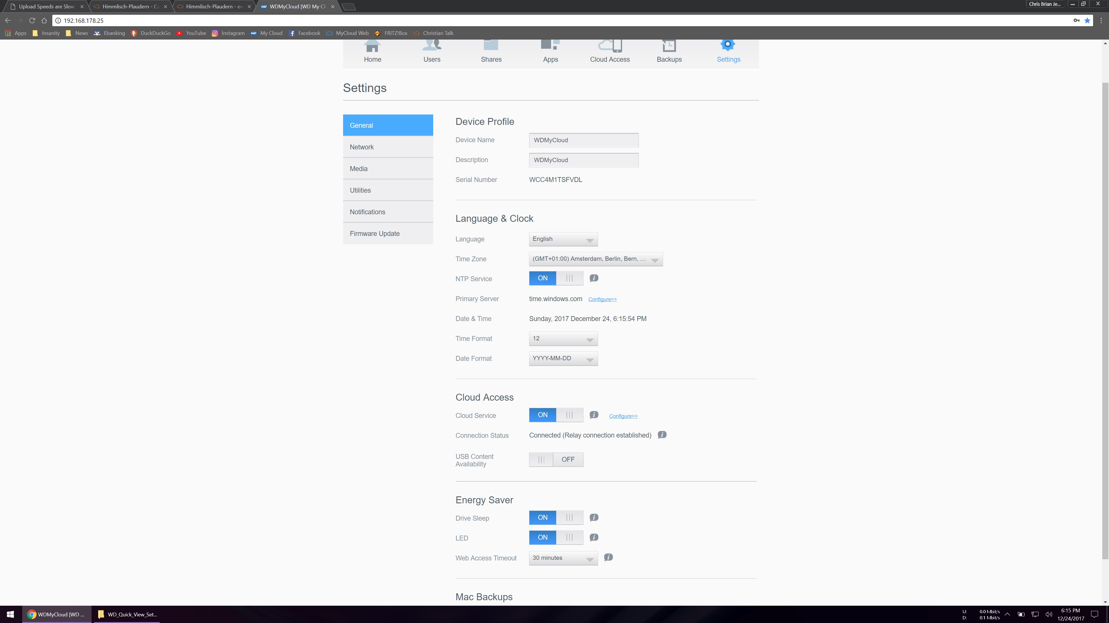

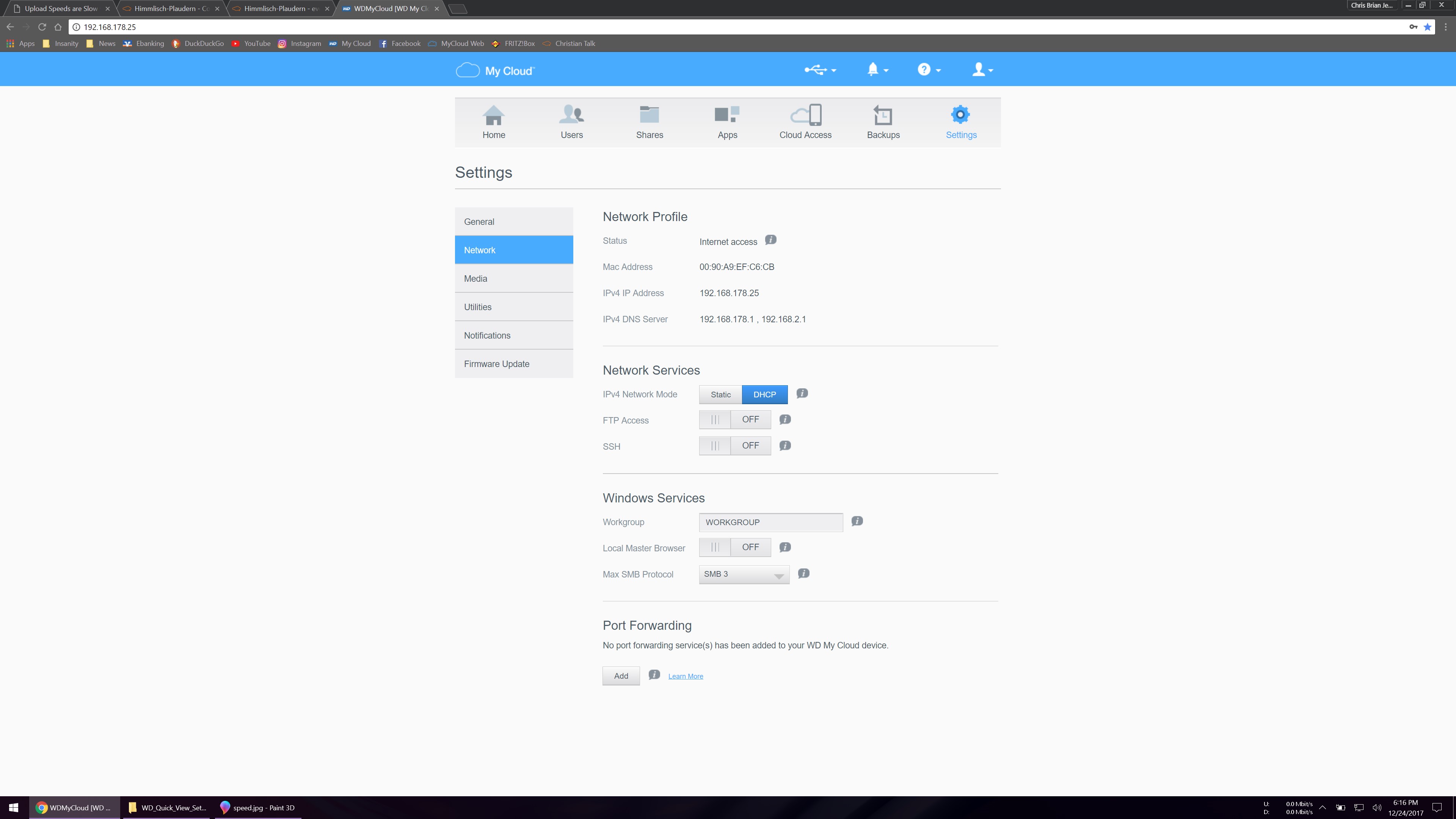

These are the settings the MyCloud is running on.
