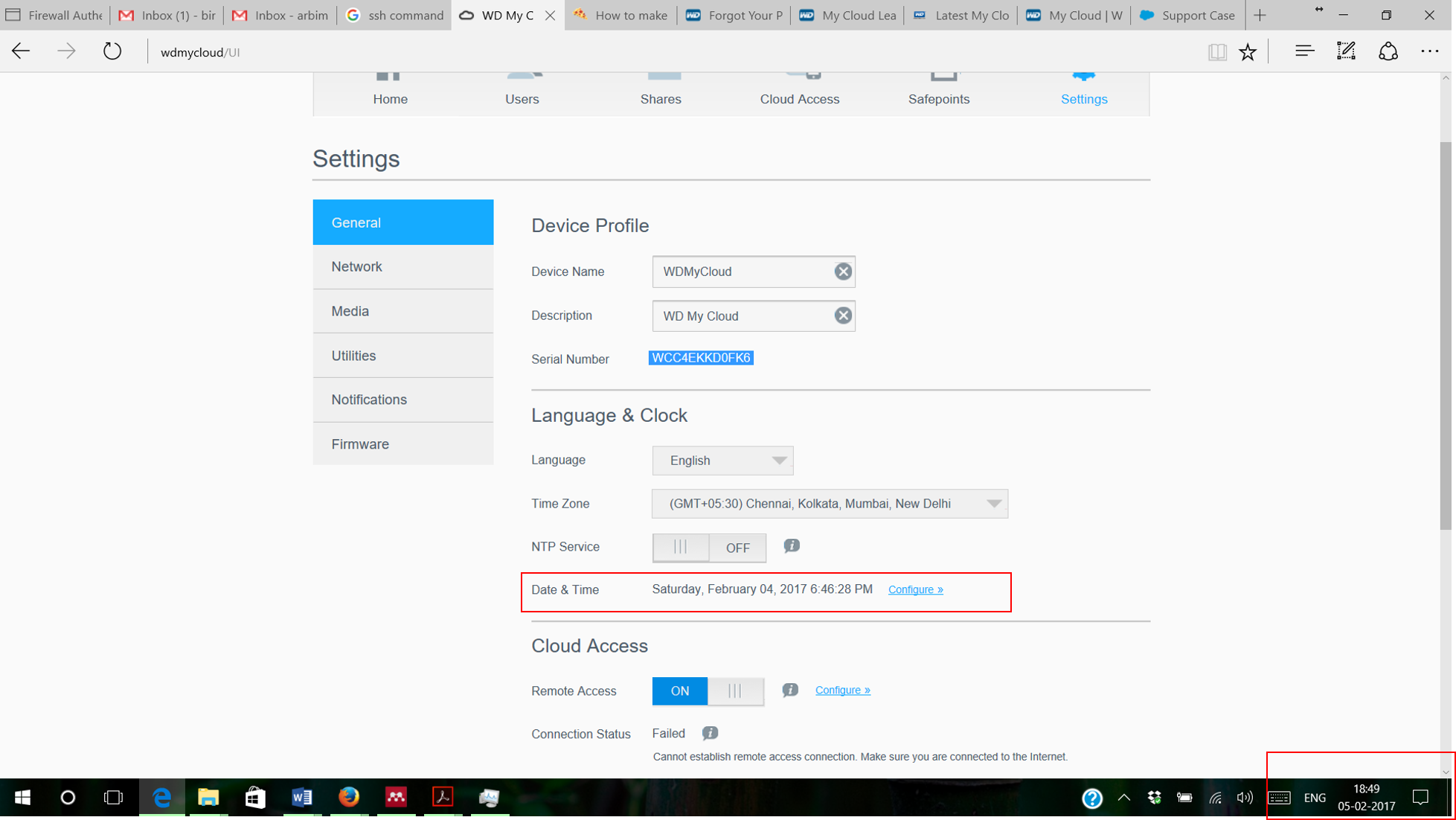

I am presently in India (+5:30)
The date is one day behind.
I am connected to the internet. I guess WD has no problem connecting to
internet, as it is checking firmware version and saying it is up-to-date.
I am able to set time correctly. But not the date.
When I pick the calendar tool to set the date, the calendar shows the WD
date (wrong date) and Correct date (Probably it is picking that from the
computer) as highlighted. But when I pick the correct date ( any other date
for that matter) doesn’t get reflected on the system.
When I attempt to change to any other time zone, the date also get changed,
but still 1 day off for the new time zone.
My guess is that, somehow, the internal clock, which gives GMT time is
running one day off and something is preventing from updating it.
Mean while I tried first level system restore, but not of any use.
Please see screen shot of the UI attached along with.

NTP was set off, because it was not working.
It was not syncing to right date and time even after keeping it ON for
days. It was always connected to internet. The system was able to check the
firmware update, and that means, it was able to communicate to internet.
Do you think it is an issue with the hardware?

Yes. I was able to solve the problem by simple ‘date -s’ command through
SSH. I think the issue is with the firm ware UI. Also my onboard CMOS
battery seems to be dead.
Mean while the WD support team told me that the only way to solve the issue
is by complete reset as the system only reset didn’t work.
But the simple date command solved the problem.

I think it is a bug in the firmware or UI. Once the CMOS battery which is
keeping the internal clock updated is dead, the firmware does not update
the time from NTP.
Also in my case, the UI was not updating the clock when I tried manual
updating.
However, you can solve the problem partially by updating the clock using SSH
The steps are as follows.
Login to your WD using the UI and enable SSH
Download an SSH client, like PUTTY
Login to WD through PUTTY (Login: root Password: welc0me (default)
Issue the command
date --set=“4 APR 2017 15:55:00”
Correct the date and time.
Log off from Putty
Now onwards do not shut down WD as the clock will not be updated. In case
you shut down, you will have to repeat the process to update the time.
