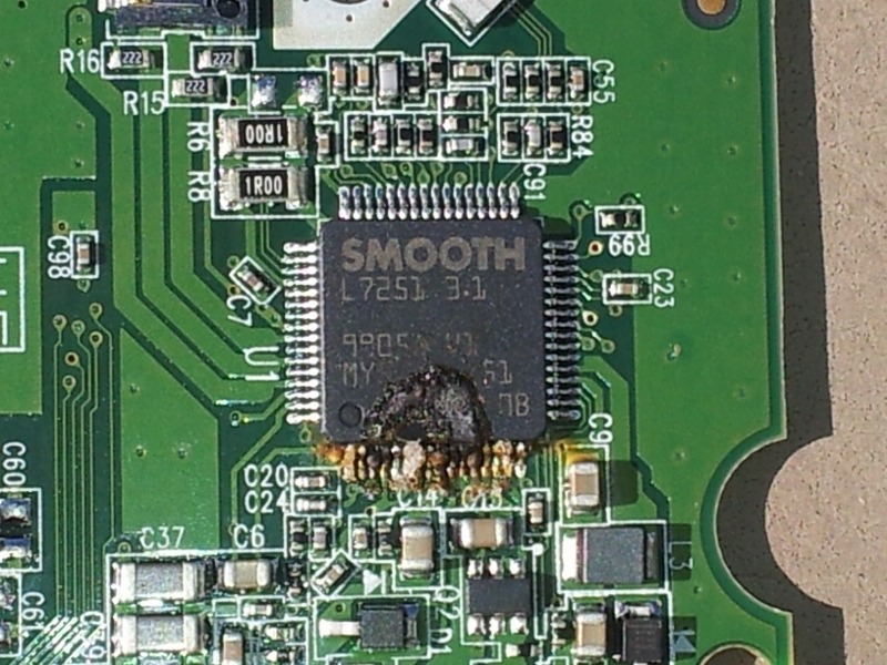

Can anyone advise how I go about getting new boards for these, I somehow managed to connect an extesion splitter power plug 1 in 2 out the wrong way round to the PSU feed, DOH!!!

Hi there are sites on the net you can buy the boards from. But you will need to use a chip from the old pcb and replace the chip on the new pcb with it . This involves soldering a chip from one board to another so it is not a job for a normal user. This is one site for the pcb’s  http://www.donordrives.com/
Thanks Hammey, have emailed them with some Q’s, looks like the D1 and 2 did not blow as is the usual case, Friedthe Motor Combo IC: L7251, U1 instead.
