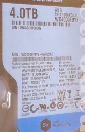

I just got another DX4000. This one came with 2 2tb drives, Can I replace theses drives with compatible 4tb drives?
IE: WD Se (WD4000F9YZ-09N20L0) 4TB w/ 64MB
From the drive compatibility list 4 TB Hard drive (WD4000F9YZ-09N20L0) DX4000 - 16 TB / RX4100 - 16 TB.
These drive should work correct?

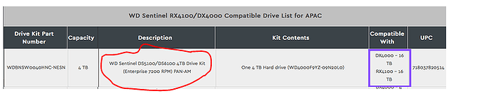

From what i can tell the drives i got are on the white list so it should not be a problem unless i am incorrect.!
19%20AM
The drives i have…
the whitelist in your picture is for the DS5100 not the DX4000
The Highlighted far right show compatibility

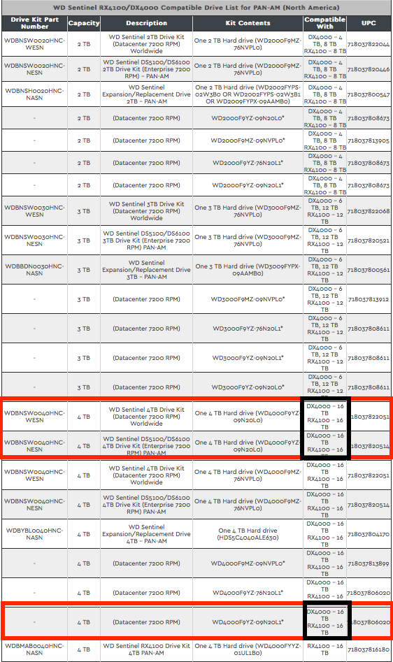

This is what I am looking at
I know i seen that,
I figured since there was no specific entry for DX-4000 for 4tb drives & found these drivers they were my best option. I have them highlighted. What is the drive file you had mentioned that might need editing or files.
Gramps your a huge help BTW,
yea, I see them listed right above where you were before. From that it does look like they will work without any tweaking. But you will need to just take the 2tb’s out and start fresh with the 4’s
