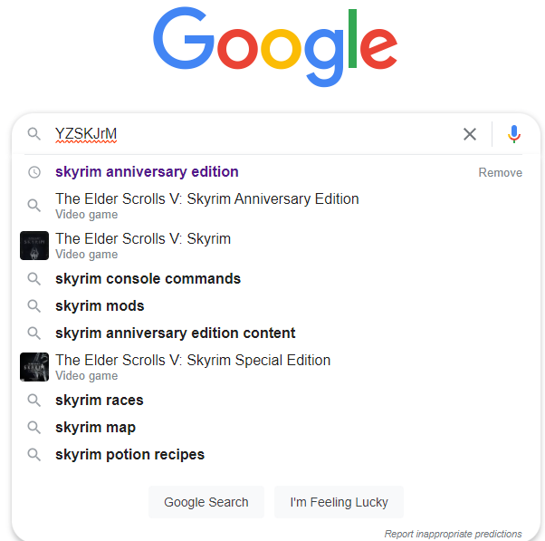

I am using a WD My Cloud Home 4TB. My home directory has hundreds of files in it which appear to be system generated. They have no file extension and the names of the files appear to be random such as “ZmHlqWc” or “YZSKJrM”. They also vary dramatically in size with some being as small as 1KB whilst the largest is 63 MB.
In total, I have 344 of these files taking up 6 GB. I don’t mind that so much if they are important but I have over 300 files in my home directory cluttering it up.
What are these files? What are they for? Can I delete them without any issues?
