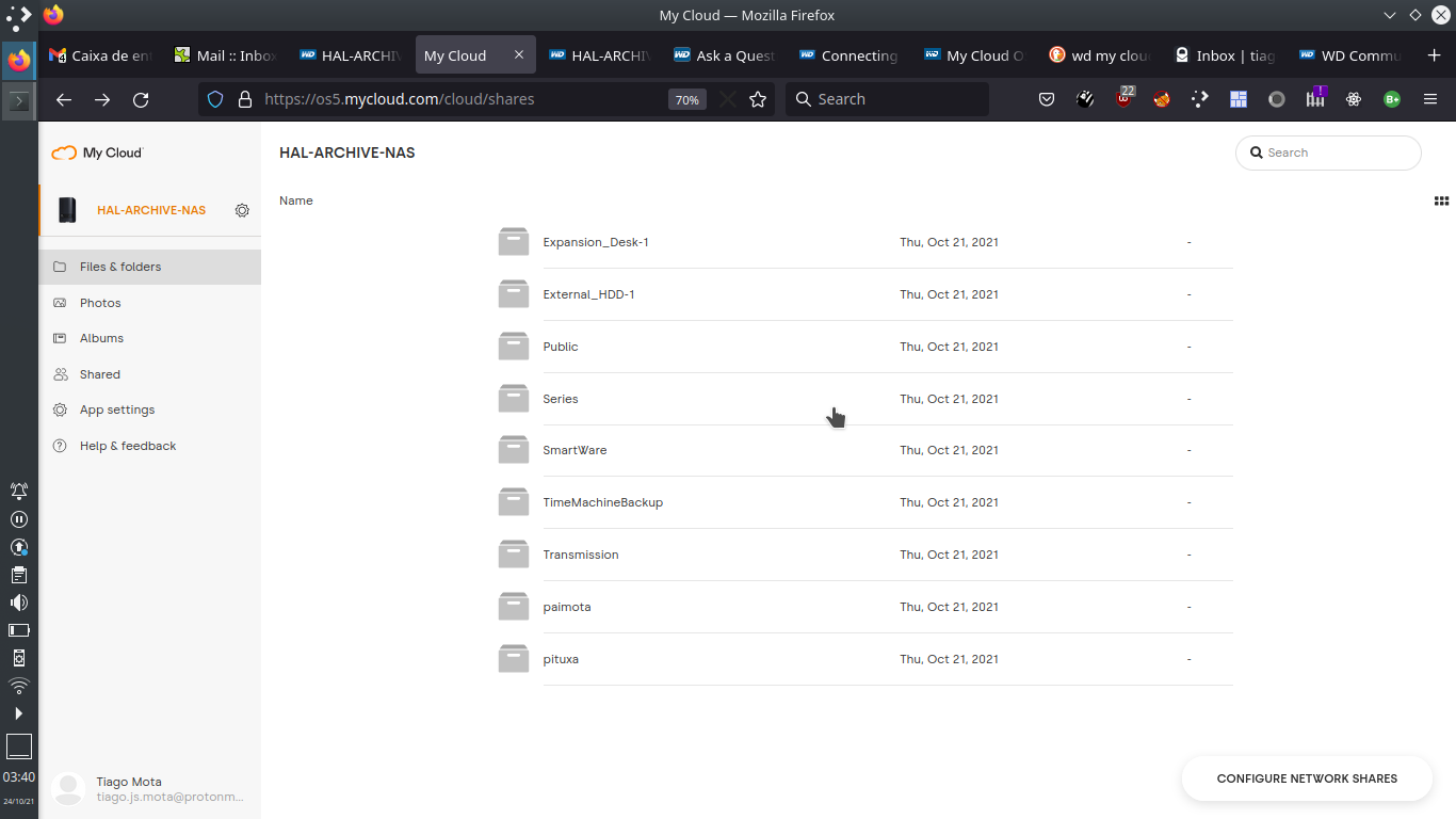

I have 4 USB external drives connected to my EX2 Ultra, 1 connected directly and 3 via HUB.
After upgrade to OS5 I’m no longer able to access some USB drives in the app.
As you can see in the prtsc, the dashboard(previously I mention this as the admin) correctly detects all 4 external usb drives but the app only sees 2 of them and curiously with different names.
When I upgrade to OS5 only 2 of the 4 external drives were connected.
What I’m I missing? Do I need to configure something? Is it a bug? In the previous OS I never had this problems.

Not a powered HUB it’s something like this one in this picture.
I can access the drives through ssh or in an file explorer. The HUB is doing is business as usual the problem lies on the client app.

Click the Share Tab, Select the USB Share and make sure Mobile & Web App Access is enabled for the USB Share. Toggle ON will enable Indexing of the USB Share
Thanks @SBrown that was what was missing.
