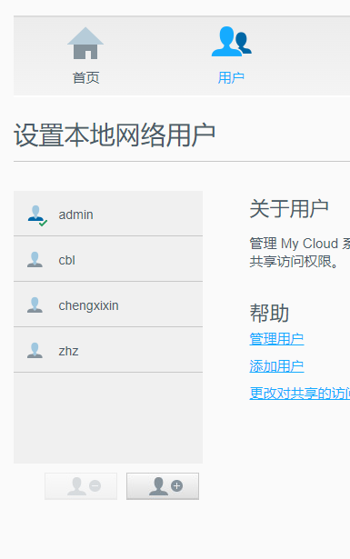

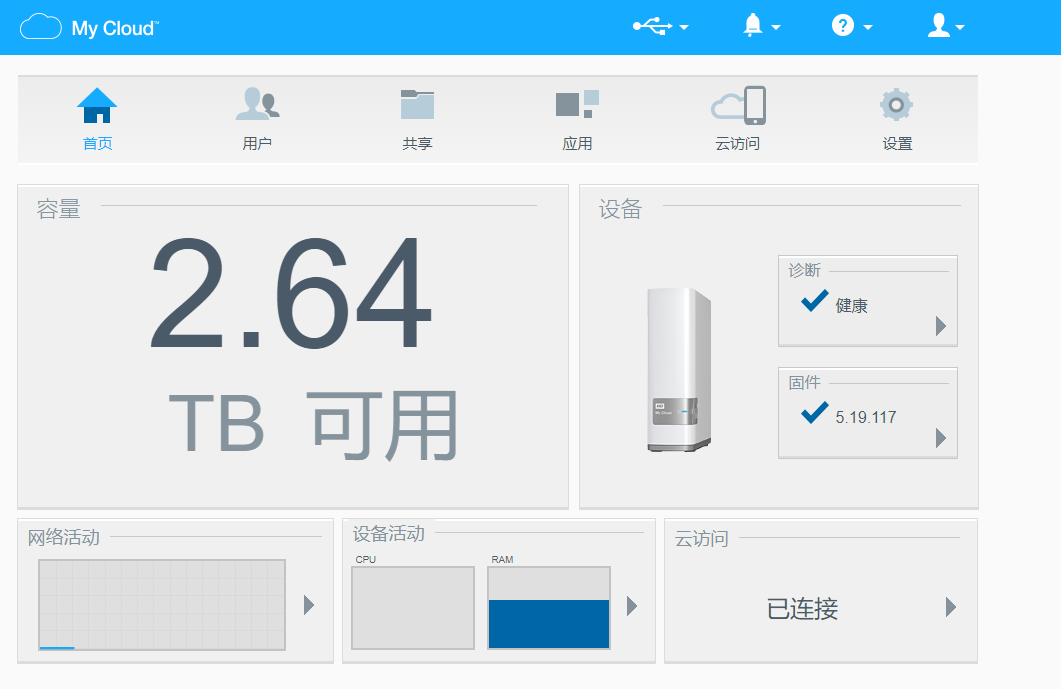

I suddenly find out that there is no group tab in the user section of my my cloud dashboard, so I am not able to create group and assign user into group. Is there anything wrong? Also my web portal login page does not seems to be OS5 (still the old OS3 page). But the dashboard does show the current firmware is 5.19.117.

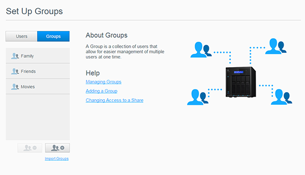

See the User tab. Per the My Cloud OS5 User Manual - Groups.
https://products.wdc.com/nas0s5/nasum/en/#t=MyCloud%2FUsers%2FAbout_Groups.htm
Viewing Groups
  1. On the Navigation bar, click Users to display the Set Up User screen.
  2. Click Groups .
  1. To view group details, click a group name on the left pane. The group profile appears.

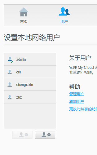

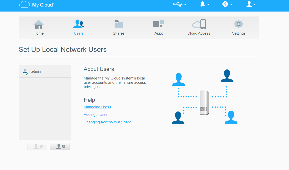

I know these, I read the manual. And that’s why there is this thread. check the following snaps, you will see there are lots of weird things on this Chinese version web portal. I tried to switch to the English version, but failed. I doubt the portal is shipped with the firmware, and there is something wrong with this Chinese version 5.19.117. Is it possible for me the re-update the firmware with the English version?
firmware 5.19.117
missing group sub tab in user

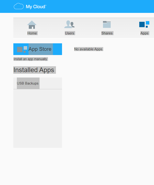

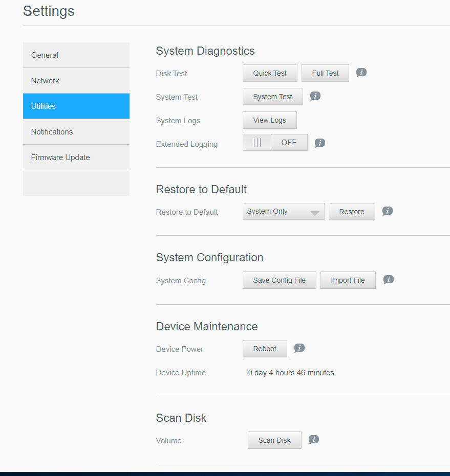

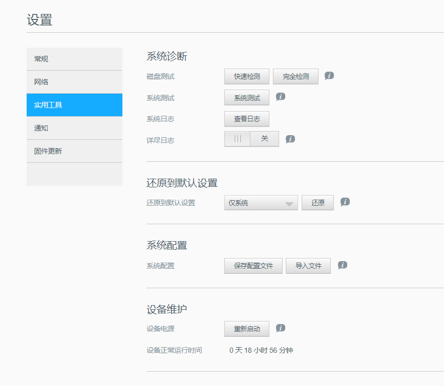

missing shutdown, missing local nas backup, missing remote backup

Tried this 40s reset, using English version now, but still the same. No group, no shutdown, no internal backup, no remote backup. Grouping, shutdown, internal backup, remote backup, these are the very basic functions a NAS should provide, I can hardly believe mycloud being not.

BTW, there is nothing in my App stores, so there is nothing be to installed about, FYI

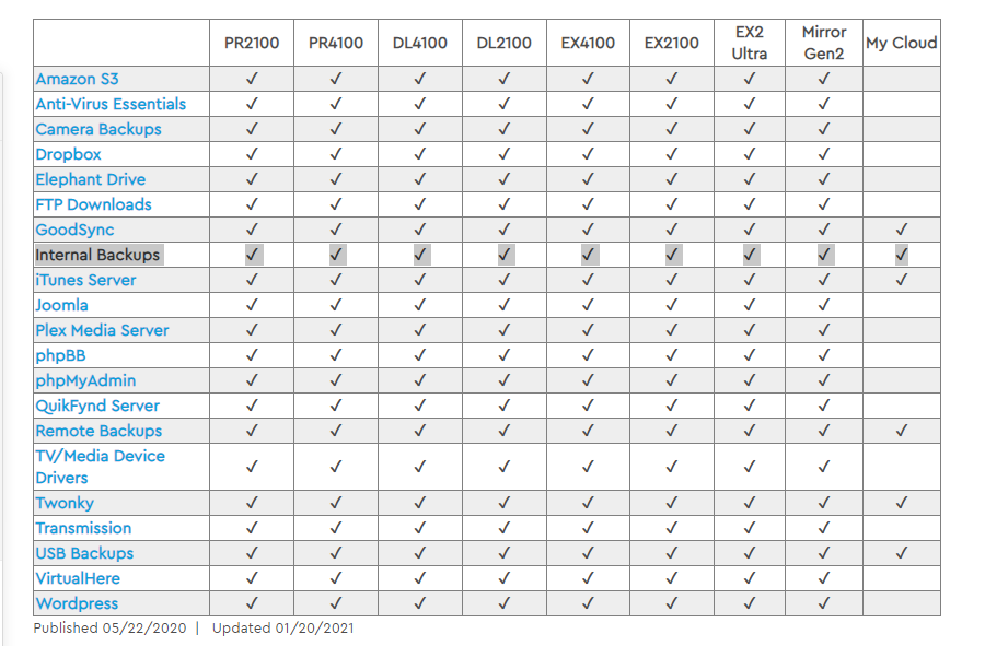

The My Cloud OS5 User Manual is a general use document. It is not tailored to a specific model. As was the case with the OS3 (v2.x firmware) for the single bay second gen My Cloud there were features and options that the multi bay My Cloud models supported that the single bay model does not. Primarily this is due to the different hardware (Processor/RAM) used across the various models. Same is true for OS5. There are certain features and options that were not carried forward from OS3 to OS5. There are certain features and options the single bay second gen My Cloud does not support. This includes certain third party apps not being available on the OS5 single bay My Cloud. One can read the following WD Knowledge Base article to see which apps are not supported by their OS5 My Cloud model.
My Cloud OS 5: 3rd Party Apps Matrix
https://support-en.wd.com/app/answers/detail/a_id/29498

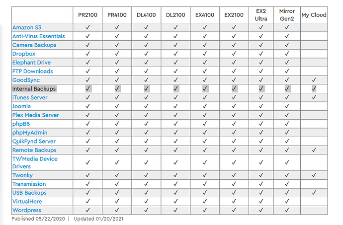

I believe, at least, the manual is wrong about the internal backup and remote backup availiability on my single bay. from the manual ( 3rd Party Apps Matrix) , it clearly shows:
however, in my single bay dashboard there is no where I can find internal backups or remote backups, see from my previous reply.

As indicated those backup options are supposed to be installed using the Apps tab. If one’s App Store isn’t showing any available apps then one may want to see the following WD Knowledgebase article.
No Available Apps on a My Cloud
https://support-en.wd.com/app/answers/detail/a_id/12868
My Cloud OS 5: Download and Install 3rd Party Apps Manually
https://support-en.wd.com/app/answers/detail/a_id/29960
Note: WD seems to have a typo on the manually install 3rd party apps page in the Download Binary File section. I assume one would use the file in the first item that is incorrectly titled “My Cloud Mirror Gen2:” for their single bay My cloud model. The file link:
https://downloads.mycloud.com/os5-apps/apps/GZA/GZA_WDMyCloudG2/GZA_WDMyCloudG2.json
