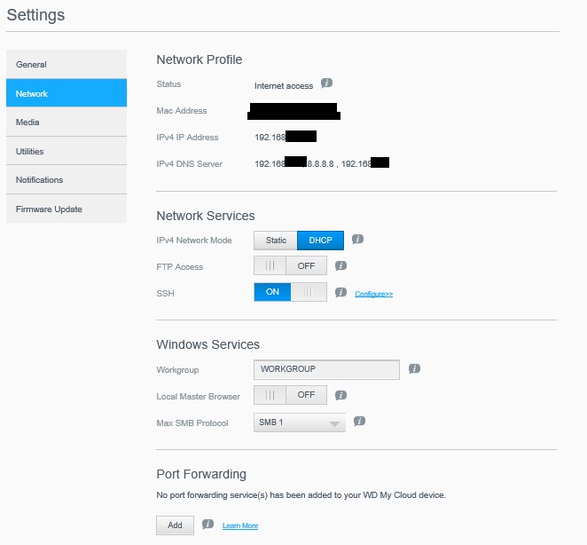

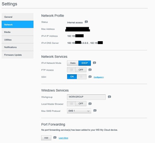

Why is the ‘NFS Settings’ as shown in the setup instructions absent? Do I need to enable it through another setting? Screenshot of Network configurable items:

@wierzej: What version firmware is on your device? As I understand the (2.xxx) indicates generation 2 hardware. I updated the OP with a screenshot to show that NFS settings are not available under Settings->Network. You comments are appreciated

Check the Share page in the My Cloud Dashboard and select a Share on that page. If there is a NFS setting it may be located there.
Keep in mind however that even though certain graphics in the v2.x single bay My Cloud User Manual may indicate an option being present, the actual Dashboard page may not have that option available. There are several errors in the v2.x single bay My Cloud User Manual.
