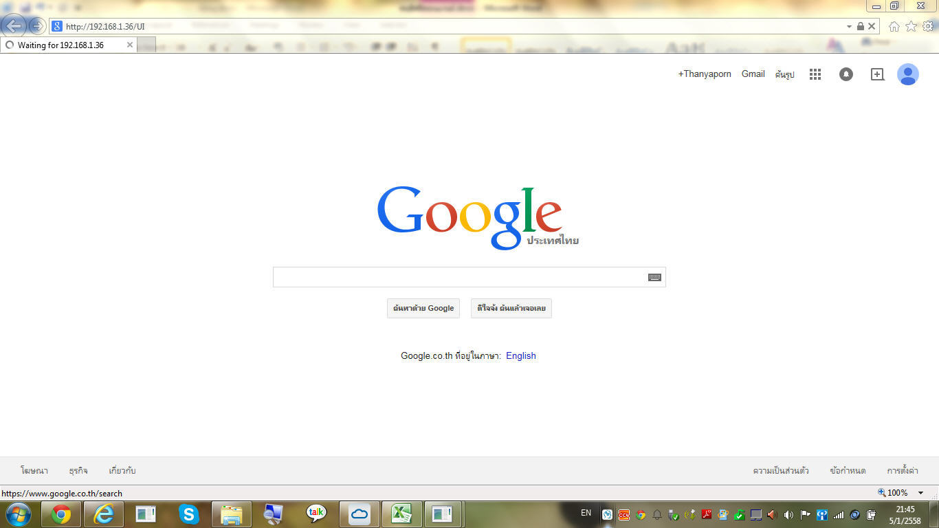

Hi Nazar78,
I had try to done like as your advise. MyPersonelCloud IP is 192.168.1.36. My notebook connect via wifi
ip is 192.168.1.38. And when I try to start Dashboardnwith http://192.168.1.36/UI it still blank page as below:
And I try to ping MyPersonelCloud and ftp to MyPersonelCloud it can ping and can ftp normally as below:
Any idea for suggesstion please.
