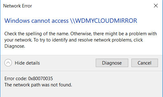

The 2nd big system is now copying all the data to my 8TB WD easystore unit and its taking 35 minutes to back up 200GB so I will be safe or safer. still no idea why the main system can no longer access it. I am using the main system to write all this. It tries the MS diagnostics to find why the unit is not coming online but can’t get past there.

I have access to the MCM from all systems but the main and that is where I need it most. I can use the Logitech Ero software to move all sizes of data through the network to go to the 2nd system to put it on the MCM but that is so cumbersome. I do want access to the MCM from my main system which is a Ryzen 7 2700 with 32GB DRAM and 1TB NVMe SSD. WD Access and quickview both can’t access it.
On the specific machine I’d check firewalls, anti-virus and any similar software which may be blocking or tying up ports which could stop communications.
That is a psuedo name, could it be different than others? I will try to see what the psuedo name is on the other systems. Do you know how to resolve that name???
If you haven’t given your MCM another name then that should be the correct one (you can rename it under the dashboard, WDMYCLOUDMIRROR is the default). If you have then that’s the name that needs to be used before the double-backslash.

If not then try accessing the MCM via its IP address (use \\192.168.x.x , inserting the correct IP address for the MCM which you can get from your router’s client table).

Also, the IP addressing method no longer works. It just times out. Samba 1 is not in the windows features as an option, just gone completely.
