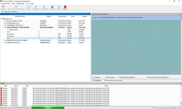

After this moment i have tryed any recovery solution posted as, DiskInternals, R-Linux on Windows and even try under Ubuntu with Test Disk, PhotoRec and tryed to mount the hdd with no success except the trick wrotten on this web with fuse2ext.

In all this scenarios it just recover like a system folders (see image):
but nothing about the files stored, althougt as you can see in this image Gparted shows about 240Gb ocuppied, what it is an accurate measure on the files that were stored in this unit.
I still believe that files are there, but i dont understand why there are not displayed or recovered.
