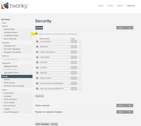

What do you have selected in Twonky under Security? See example image below. Click on, tap, or activate image to enlarge it.

Just verified, the “enable” is well checked.
Not sure about the type of receiver, but not sure it makes a difference (I have choosen Generic Music Only Receiver.

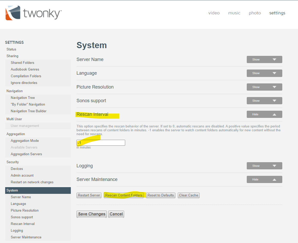

Have you already rescanned your folders? What do you have set for rescan? See image below. Click on, tap, or activate image to enlarge it.
I have the same setting and I did the rescan several times.
As explained the app coming with the streamer (Advance Playstream) displays correctly the content of the disk based on the defined navigation tree of the Twonky and with the right album covers …etc but when listening to a song I got no sound and the duration is 00. For an album, I see all titles displayed quickly and then it stops on the last one.
