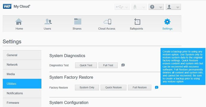

For reset/restore see example image below and read all the Help (?) information provided in the Dashboard. Click on, tap or activate image to enlarge it.

If you have changed ethernet cable, router port & reset the router, try resetting the MyCloud.
If neither 4-second nor 40-second resets work, your network port may be dead. The lack of port LED activity shows there is no connection between MyCloud and router. One end, or cable, is broken.
