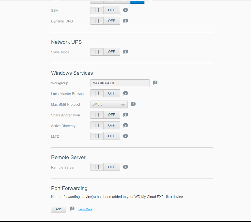

Hamed from tech support updated my ticket, asking me to “disable port forwarding” and reboot the drive. The problem is, there is nothing under “Settings” → “Network” → “Port Forwarding”. So how do I disable it?
Any idea? Thanks!

Solution: I did exactly like the post instructed, manually config WD Cloud service on port 9080/9443, and created port forwarding rule on my G1100 router. I also took the extra steps to add Port Forwarding under WD Admin Panel->Settings->Network->Port Forwarding, added both port 9080 and 9443, for HTTP and HTTPS respectively.
