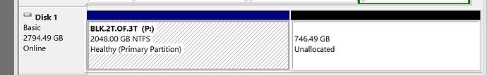

3 tera hdd. Partially allocated.
The proprerties above shows the difference between the two partitions.
i.e partition #2 cannot be accessed.

Hello, have you tried to format the unallocated partition? Check the link below for the steps.
http://wdc.custhelp.com/app/answers/detail/a_id/3865
If you reformatted the drive it needs to be GPT for drives larger than 2 T not MRB.

Still partially allocated.:womanlol:
Someone has suggested that it’s a bios issue.
Should I ebable bios update option?
