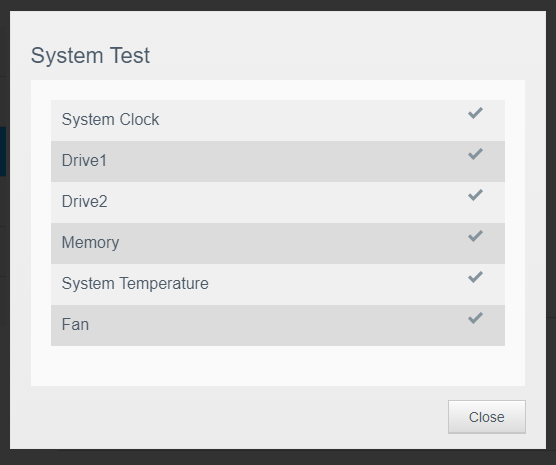

Here I have a similar/probably same situation.
I have replaced the two 3TB HHDs wit two 16TB, I even replaced the 36W power suply with 48W one.
Everything working fine and then after 2-3 days I recieve the Caution regarding Drive status fault.
I have completed quick-, full-, system diagnostics tests but everything is OK.
As i restart the WD MY Cloud ex2 Ultra, the red flash on the HDD is turning blue again for 2-3 days, then Irecieve the same caution notification, as everything working well.
