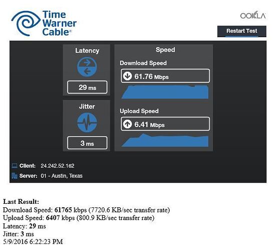

Here is my setup and I have Time Warner Cable as my ISP. I own my modem Motorola SB6121, My My Cloud is connected to my Linksys Router 1900AC using a Belkin Premium Flat High-Speed CAT6 Cable and my router to my Modem by the same type of cable. Below is the latest speed test check I have made. See image below.

Are you positive these are UPLOAD speeds, because they might be DOWNLOAD speeds? ISP always list the download speeds first, and hardly ever mention the upload speeds because they are so much lower than download. For example, my ISP is Comcast, and the basic internet plan with them today is 50Mbps DOWN/ 6Mbps UP. I have the next tier plan that is 100Mbps DOWN / 12 Mbps. To get higher upload speeds I would need to pay them even more. ISPs are quite stingy with higher upload speeds. I presume Comcast offers lower speeds, but they are not part of their basic offerings.
