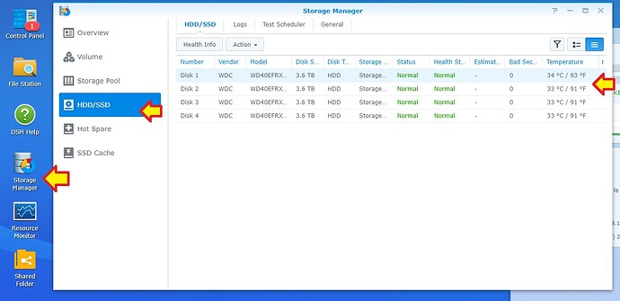

@justlinux Where i can find in synology this table with disks

On my Synology desktop I open “storage manager”,
then on left column I open “HDD/SSD”,
disks list opens, if I go to top right corner and change view …
I now see a table with disk vendor, model, size, temperature, etc.
Click the dots on top right corner of the list to select data to be shown in table (serial number, bad sector count, etc).
