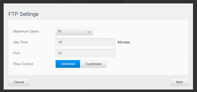

So I’m trying to reach my device from outside of my network. I’ve created a dynamic dns host (dlinkddns.com) etc. but in the ddns settings I’m getting an “Updated Failure” message. Host name is correct, user name or key is correct and pass is correct. I’ve port forwarded 2121 in FTP settings and Router.

Turn on FTP access in the network settings in the NAS.

Set a port forwarding rule in your router to forward any TCP packets sent to the router’s external address (myname.dlinkddns.com) on port 2121 to the internal address of the NAS (e.g. 10.1.1.10) on port 21.
You have the filezilla hostname and port correct, myname.dlinkddns.com:2121, normal login, the user and password are the user and password that has access to the share.

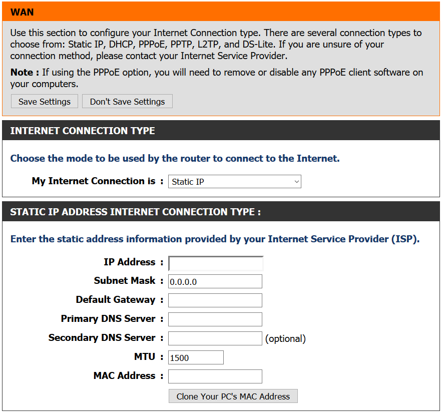

When you say I need to setup static IP in the router. Do you mean I need to do a “manual internet connection option” and connect with static IP rather than Dynamic (DHCP)? Right now I’m using Dynamic. I’ve changed to static IP in both my computer and NAS. I’m not sure how to do step 4 in the router.

You need to reserve a DHCP IP address for the NAS in your LAN set up in the router not the internet connection setup.

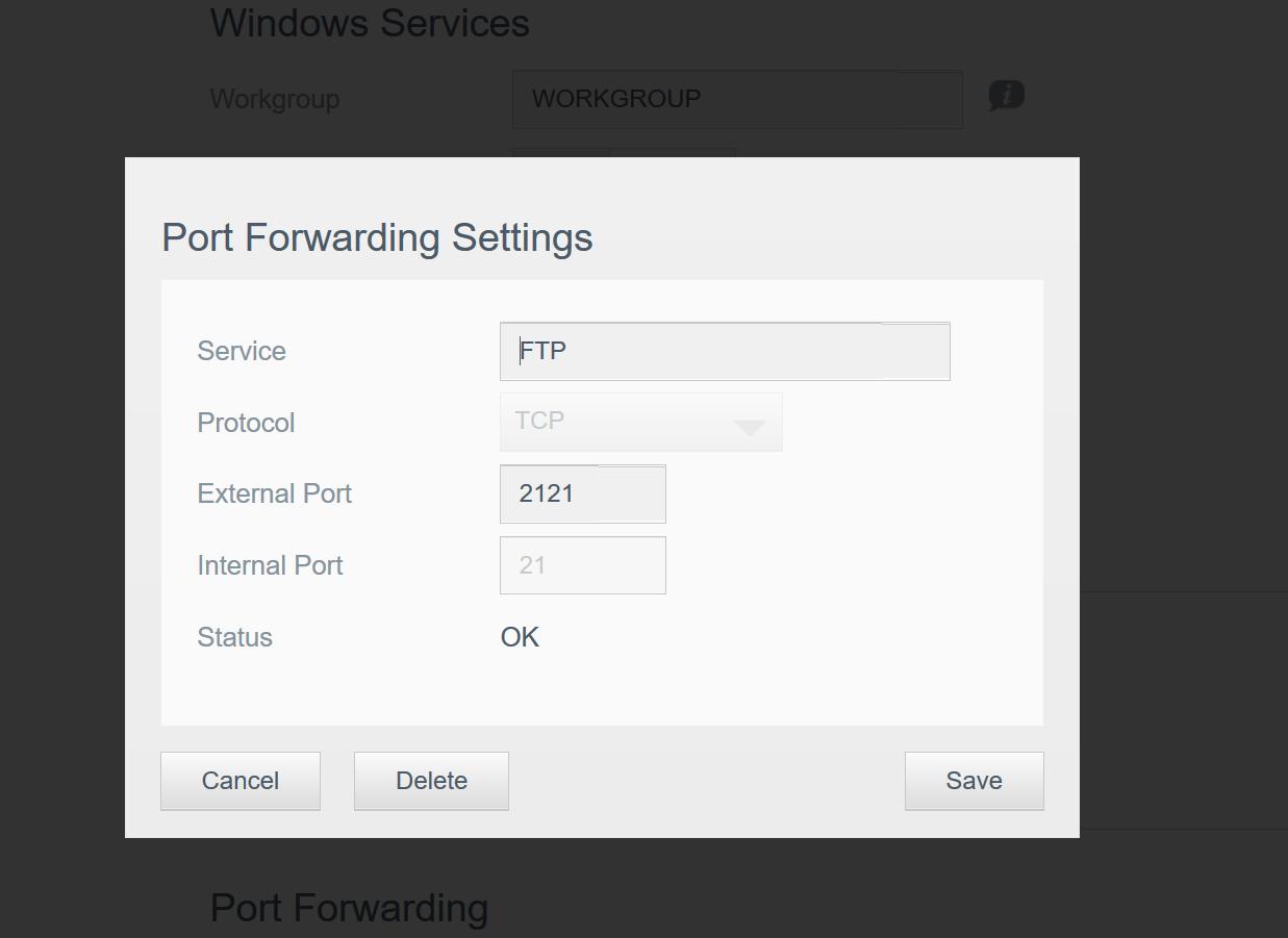

I don’t see where you have forwarded port 2121 to port 21 (the port the NAS will be listening on). If there isn’t an option to do this in your router you will have to set your NAS FTP port to listen on 2121 as well. This is what it looks like on my router. Notice that port 2121 will be forwarded to port 21 on 10.1.1.10. Yours only has the external listen port (2121) specified not the internal port the NAS will be listening on (21 as default). There may be an option to tick to let you specify different ports. (click to enlarge)
