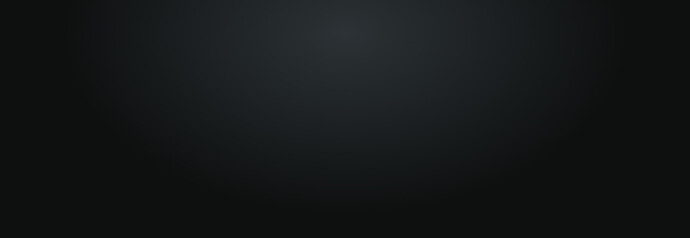

the problem is that there was an electricity cut during reformatting
when the unit go on I had this screen
I try again to plug the USB key (before and after ignition of the case ) without success
Please have you a solution to offer me
thanks a lot
(and sorry for my English)
Happened to me too…
You have to delete everything on your usb key.
Put the latest firmware 2.02.32 on your usb key… (not the one you want to downgrade).
Boot the device, when you see the screen insert the usb key (wait 1 min) then reboot the device but keep the usb key in the device… It should reinstall the firmware.
Once it’s done, erase your files on the usb key and you can try again to downgrade the firmware.
