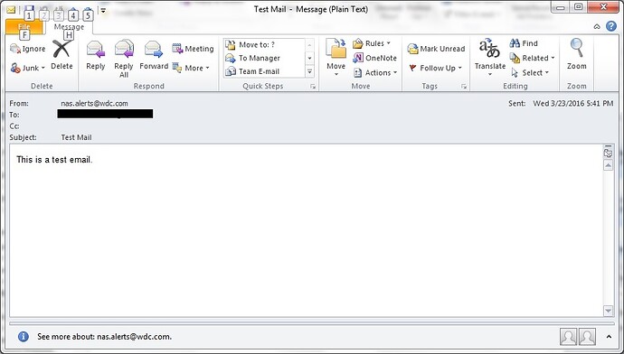

Note that in Outlook it does show the correct time (below) but the header indicates (note certain info redacted):
Received: from notify.senvid.net (notify.senvid.net [129.253.8.154])
by flpd576.prodigy.net (8.14.4 IN nd2 TLS/8.14.4) with ESMTP id xxxxxxxxxx
for <xxxxxxxx@xxxxxx.net>; Wed, 23 Mar 2016 14:42:15 -0700
Received: from localhost (unknown [xx.xx.xx.xx])
by notify.senvid.net (Postfix) with ESMTP id xxxxxxxxxx
for <xxxxxxxx@xxxxxx.net>; Wed, 23 Mar 2016 14:40:41 -0700 (PDT)

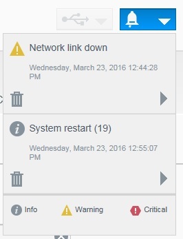

There are however certain instances where the My Cloud will indicate the wrong time due to the coding in the firmware. One instance is in the alerts menu. In the example below the time indicated is off by three hours since the network link down time and restart time were around 9:44 am EST and 9:55 am EST respectively. Other times the time used int he log file may be wrong as well.
