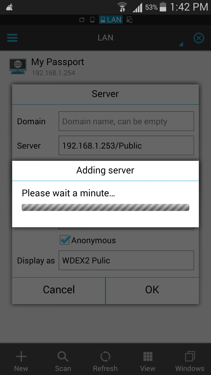

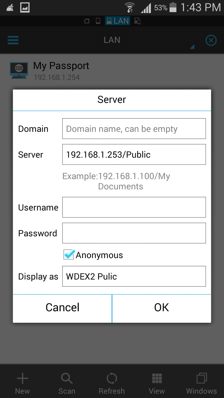

As an additional test, I have tried to connect using ES File Explorer from my android devices and the results are consistent with Windows 7 and 8.1 I.e. the shares are not accessible via samba even though I can see that the daemon is running (see attached).
