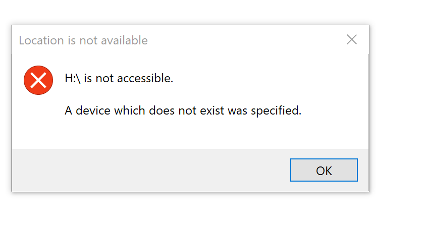

now I want to use a 2m extension cord to operate the external SSD-drive and plug the delivered cable into the plug
tested 2 different cables specified with USB 3.1 Gen2 (10 Gbps), those are identical to USB 3.2 Gen 2 in the USB 3.2 spec
I am unable to connect the external drive. the drive H is shown without status bar and windows 10 responds with a pop up error message “drive not accessible”
sporadically the drive is recognized (rarely) but it reaches much lower transfer rates.

I did more testing and figured out that I have to connect the device and the extension cord in a specific direction. then its reliably recognized and works fine, just the speed is lower (1000MB/s down to 400ish). meanwhile, I have 3 USB 3.1 gen2 10 Gbps extension cables all of which show exactly the same behaviour and similar speed results. I couldnt find any USB3.2 gen2 cables of 2m length online.
I still dont get it as to why I have to connect it in a specific direction (up/down as in USB Typ A) when using the extension cord while I can flip it both directions when connecting directly.
