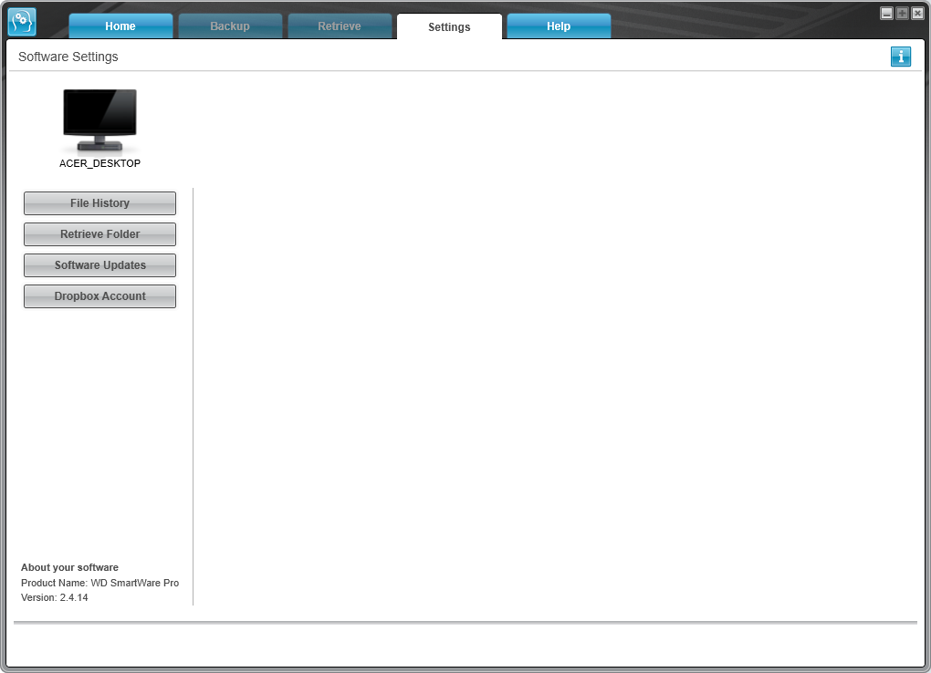

  1. What I see to indicate that backup is not proceeding. It reverts to “Settings”

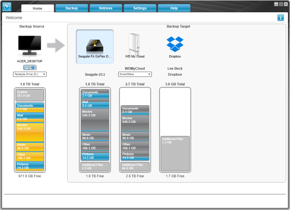

  2. The Home tab showing available targets for backup
  3. The home tab with Seagate_Backup_3 selected

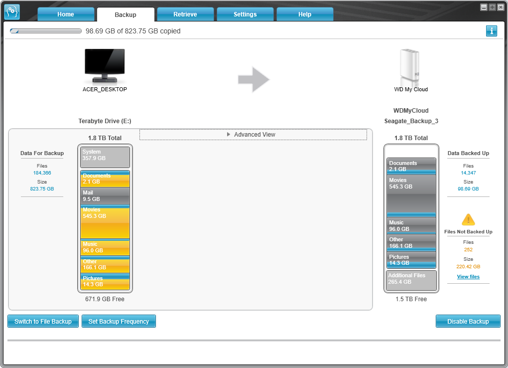

  4. Backup up and running again.

Apparently stalled again. Info that 14285 files backed up hasn’t changed for about 15 minutes. Also, strange that this number of files is lower than the 14347 in the previous screenshot in the “Files saved” category.

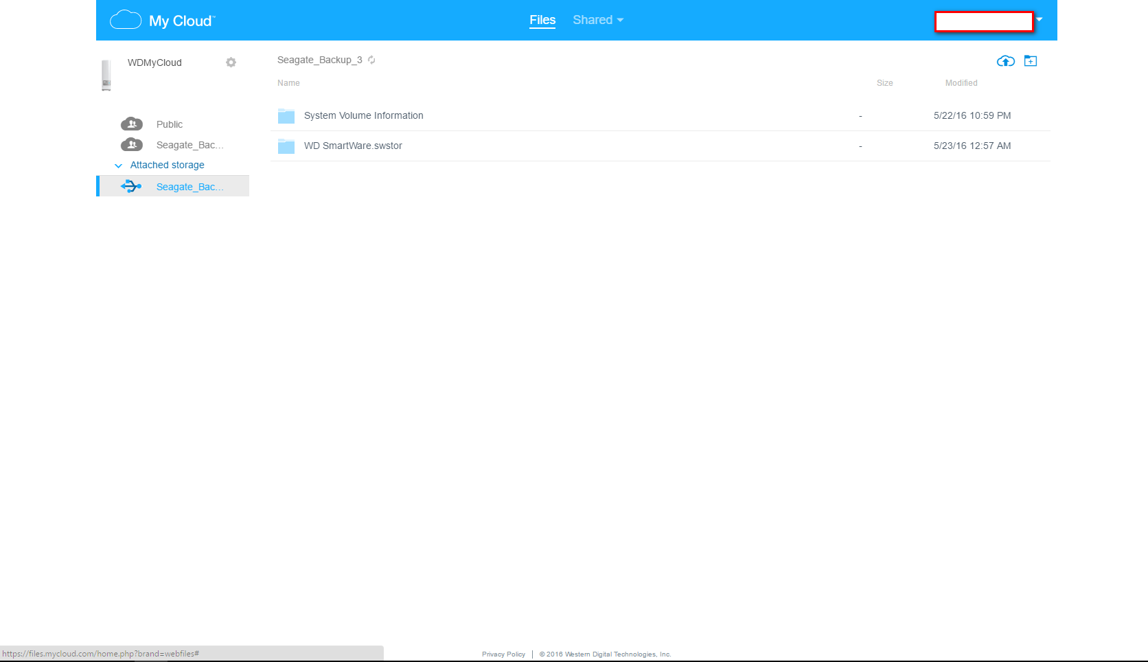

If I load the MyCloud I get a brief session where it is apparently loading some files from the Public part and then crashes with the indicated error messages.

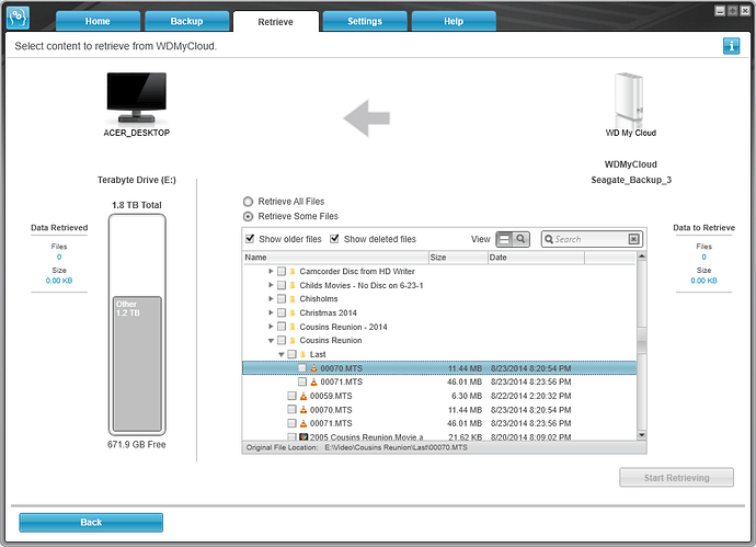

File retrieval also not working. I selected a relatively small file to retrieve as a test. Waited 15 minutes. No retrieval.

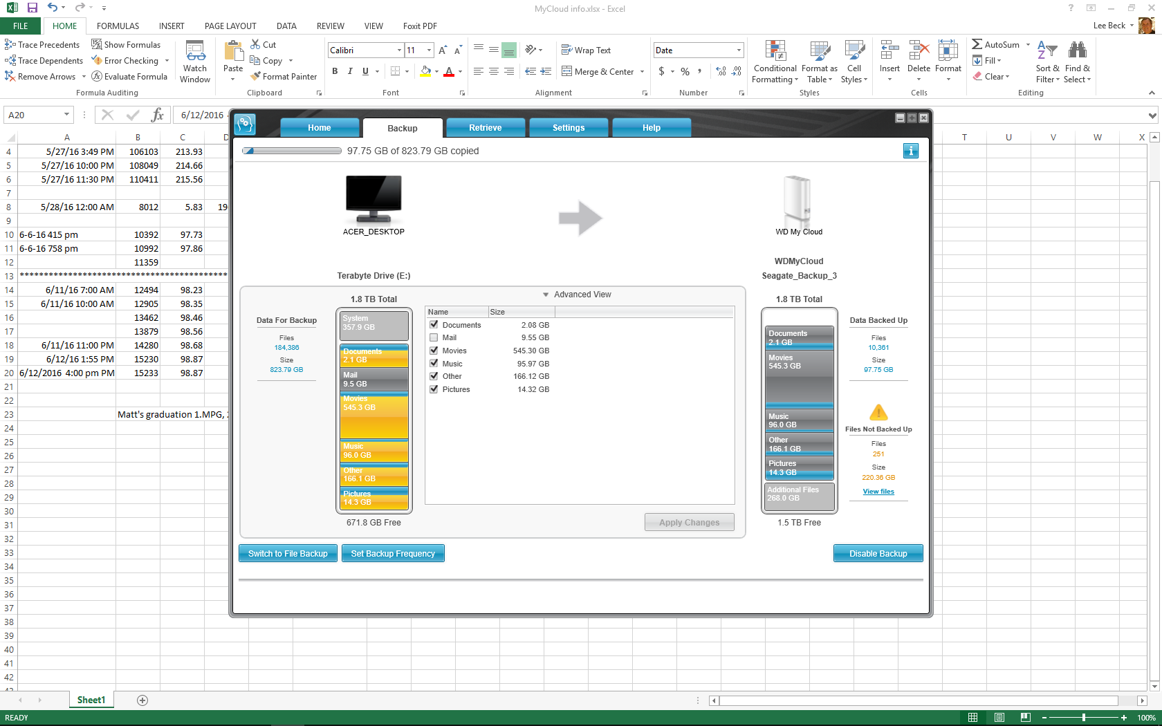

I started a spreadsheet last week to keep up with the backup progress so that I could determine what’s going on. The image below is a screenshot of the spreadsheet with the current SW report superimposed. Column B is number of files backed up. Column C is GB backed up. The large difference following 5-28 is because in desperation I reformatted my target drive, reset MyCloud, and reinstalled SmartWare to begin with a clean slate. That didn’t work.
As you can see, the backup has progressed in very minor increments since 6-6-2016.

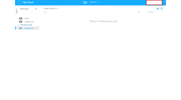

I am attaching a couple of screen captures to show the current configuration.
