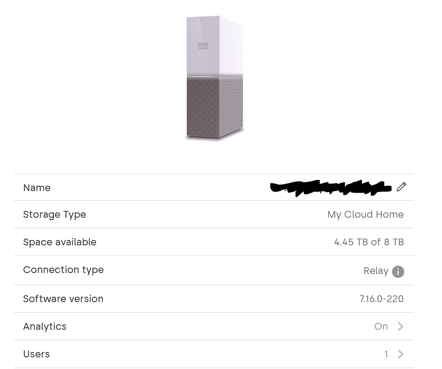

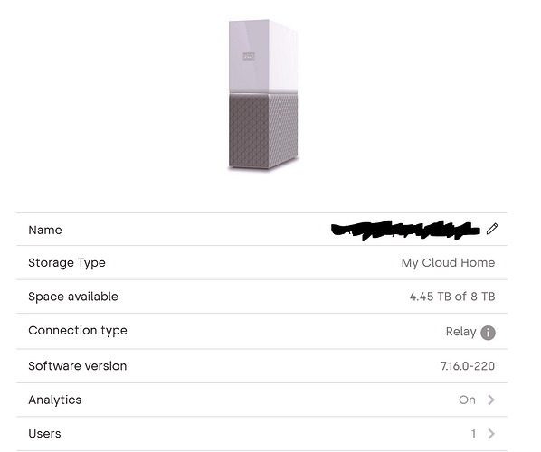

Here’s the config
On PC connected directly to router

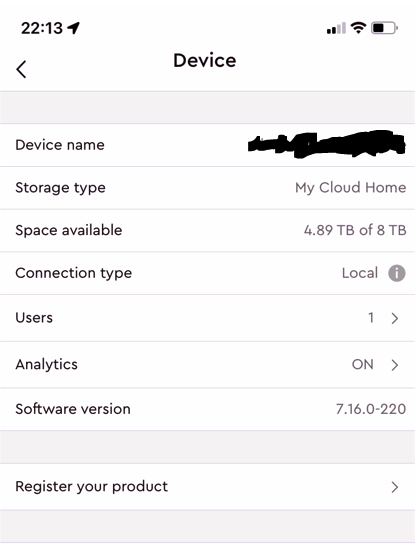

On iphone when on wifi by same router
Why is the PC not showing local, when it’s connected directly to the same router as the MCH? They’re in the same IP subnet internally 192.168.1.xxx and i’ve set the router to reserve the IP for the MCH

The iphone on the same LAN proves a local connection is the type I should be seeing.
