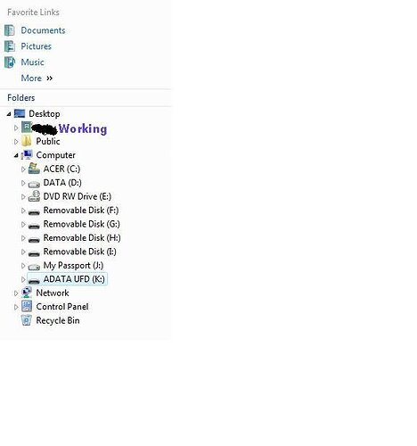

I understand from p.46 of the manual, Backing Up Files, that you select what to copy from the drop down menu under the PC/Dropbox icon. In my case that only offers Acer  (C:), Data (D:), and MyPassport. I chose Acer (C:), thinking it copies everything on the computer except program files. But it did not copy a specific category (?) named in this image “Working”.
Can you tell me what I’ve done wrong so I can correct it before I lose something? It would be my luck.
Down at the bottom of that screen there’s a button that says “Switch to Category Backup”. Press that and it’ll switch you into that mode, where you select which categories you want to back up (documents, videos, music etc) and it will then do that for the drive you select.
Personally I prefer file backup as it’s more controllable to select which files/folders you want to do (if you select a folder it should do everything in that folder aside from excluded file types, even when you add new files) but it’s a matter of personal taste which mode you use.

In your case I would probably suggest to use file/folder mode, as it’s more flexible. Category mode is designed for general non-technical users, and just backs up the specified file types without much thought, but also without much choice for selection etc.
What I would do is use file/folder mode, and then if you want to back-up the entire C: drive then just select the root of C:, which should the select all the folders within the C: drive and cascade on downward to their sub-folders etc. That will then back up the whole C: drive, subject to the exclusions already mentioned. If there are additional drives or folders that you want to do, just tick those too.
