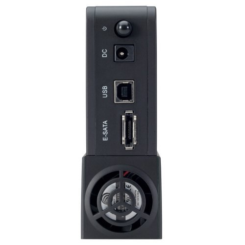

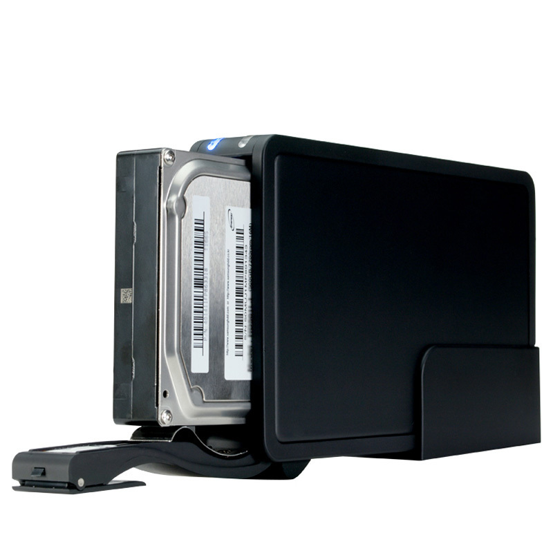

The ENGLISH version:
The Western Digital Green was used within a small computer network (drive letter W:), connected via USB port on the file server (NAS / Iomega StorCenter ix2-200 ), suddenly it was no more accessable. None of the computer (Windows XP, 2x, 1x Windows Vista) had access.
Touching the enclosure (Rec.: the WD is installed in a Fantec HDD eSata housing [http://www.fantec.de/html/de/2/artId/ 1479/gid/ 5009053090539990/article.html](http://www.fantec.de/html/de/2/artId/ 1479/gid/ 5009053090539990/article.html)) an extreme high temperature was detected which has so never existed since its use. The aluminum box of the Fantec felt in regular operation always rather cool/cold.
The Fantac showed on the LED at no fault … After waiting and cooling down, the WD was taken from the Fantec housing, and replaced by a Seagate 1TB Barrakude to test whether the error resulted from a defective Fantec dock or the WD might have caused the problems itself. The Seagate was recognized after power Fantec enclosure via USB port on a laptop computer. I.e. The Fantec case works fine.
After reassembling the cold WD in the Fantec case pressing the switch on button and connected via USB to a Windows Vista machine there came the report that a device driver should be installed. It was not quickly recognized as USB device (which normally it should do). The automatic search for a device driver was unsuccessful. The recognition was aborted by Windows Vista.
After keeping the Fantex switched on it showed again a significant heating.
